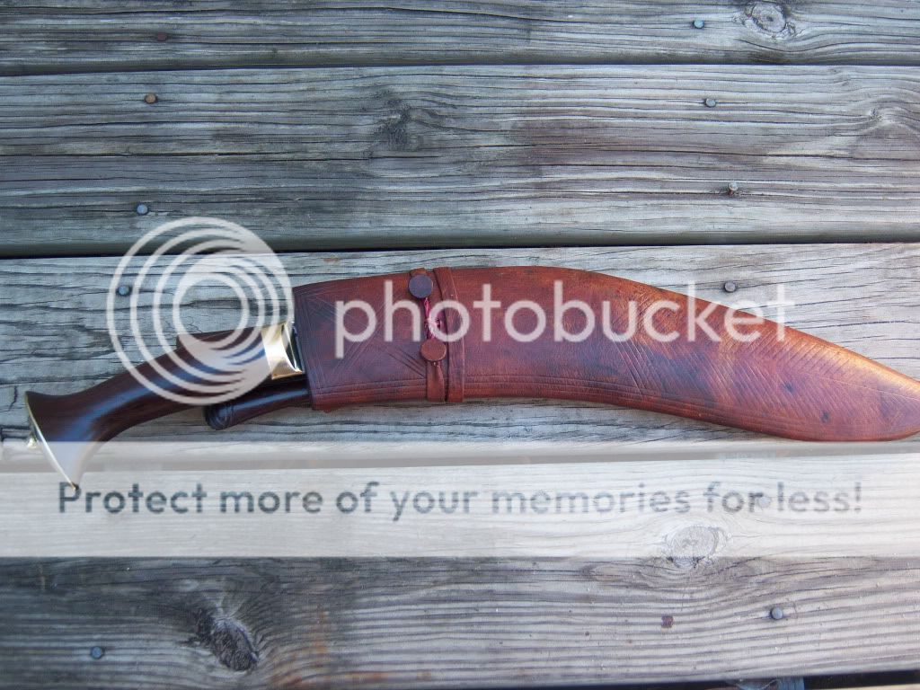

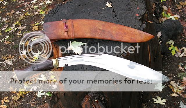

On 10/5 I was able to score this unique setup. Aunties pic, which is why it looks better than the rest of mine
Gorgeous rig, but the leather would soak up water at the touch so a bit of oiling was in order.
The stats are as follows:
22in in length
38oz
Thin for this size, it's 3/8'' at the bolster out to the shoulder, then tapers to 3/16" just before the tip.
The belly gets to 2 3/8" at it's widest point and the slim blade profile allows for VERY deep bites.

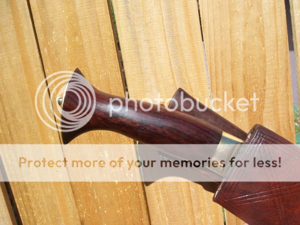

Given the weight I was surprised at just how forward the balance on this is, the balance point is almost at the shoulder a full 6 inches in front of the handle!
This forward weight made the handle ungainly for me.
SO.........................................................................

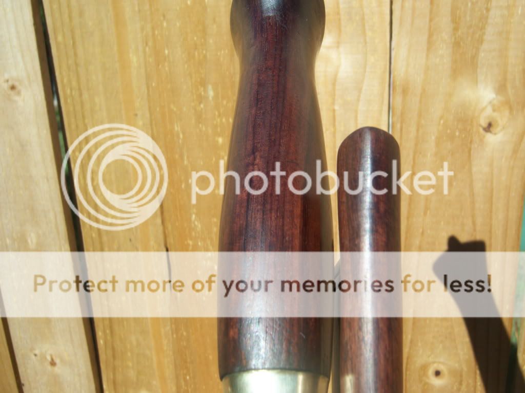

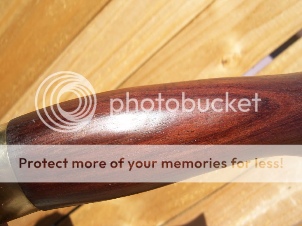

some shaving, some filing, lots of sanding, and a bit of oil later,
I took the ring off, went with an M43 inspired-clean look.
the grain on this satisal piece is beautiful. It will take several more sandings and oiling to bring it all out, this is still a work in progress.
