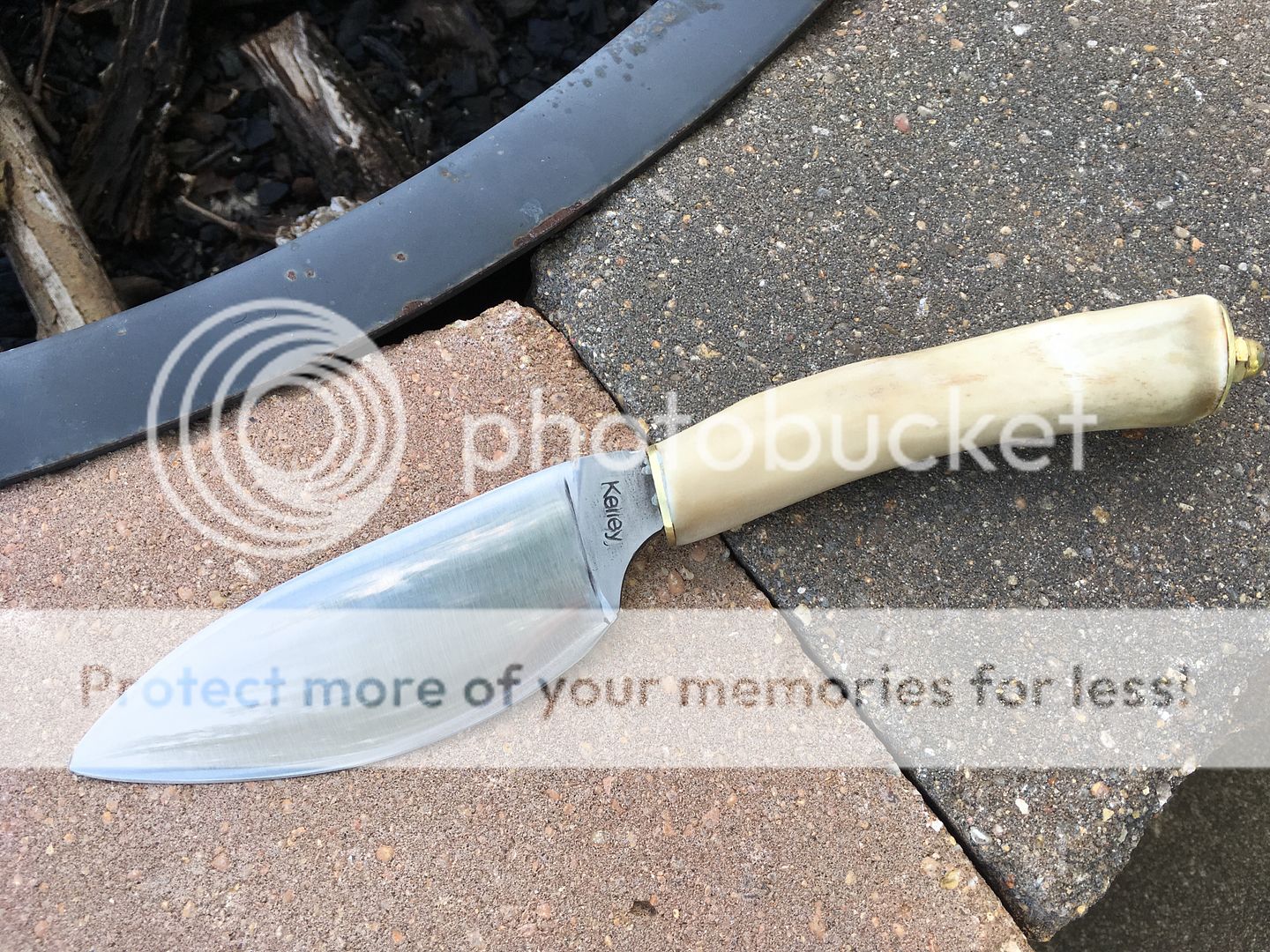

Alaskan Hunter, it seems like you have already gotten good info about bone handles with slabs. But, just in case you are open to a different approach now or in the future, here is what I do with bear bone handles. The bone stays "in the round" is cut to an appropriate length (table saw or chop saw both work fine) and the tang of the knife is run all the way through the cleaned up bone, threaded at the back end and secured to a brass rear plate with a brass acorn nut. There is also a brass plate at the front of the handle and the entire bone cavity is filled with plumber's epoxy. Here is one I finished recently:
I have made a bunch of these, all from bear bones. Good luck. Steve
