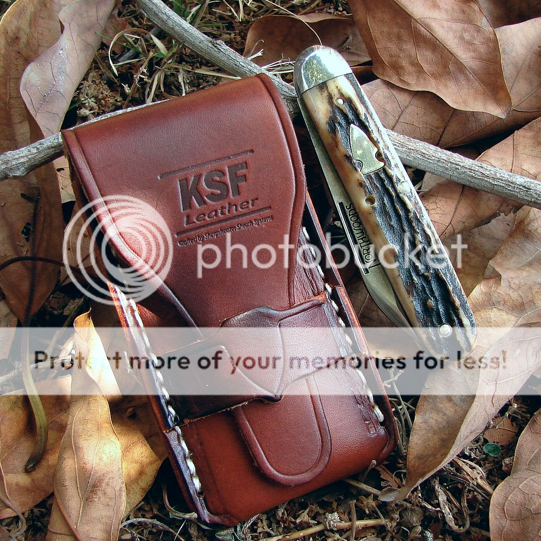

Sometimes pockets can get sweaty. How will it affect a knife with bone, horn or stag handles?
I'm considering buying a northwoods forest jack with rough cut bone, but I'm not familiar with bone, horn or stag.

You are probably aware that the Forest Jack comes with a very nice pouch. I always carry mine in the pouch and have had no problems whatsoever.
