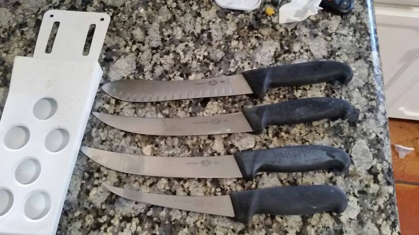

What would you all consider a "boning knife"? I had someone ask about one. He is looking for a 12" blade. I was under the impression that is similar to a filet knife but thicker (less flexible) and maybe a little bit of curve towards the tip. Blade length in the 5-7" range. If you've made one, what kind of dimensions work for you?
I too would like to know as I've had a similar request.
Here is a typical meat cutters set up. The boning knife is the bottom one with a 6" blade. If he is wanting a 12" blade, he is probably really wanting a breaking knife like the middle two.
See I was thinking of the top one, but I think the middle is what is wanted in my case. Thanks. What is the top profile called?
Just a plain old butchers knife with a Granton edge.
The boning and breaking knives are more flexible but not fillet flexible.

Hi all. The bottom is typically the boning knife . Yes usually a little stiffer than a fillet but a little shorter. So 3/32 would be a reasonable material to go with and a distal taper with a flat ground with a 6"-7" blade would probably work best. Less curve in the blade will also work well but that's sort of the traditional amount of shape. A non slip handle would also be good.

This is an 8" Breaking/Butcher's knife that I make. I first made it for a fella that processes his own wild game and was looking for a larger knife to "break" down larger animals. The blade is roughly 7/8'' edge to spine. Its .100'' at the spine with minimal distal taper so to retain its rigidity. He has been very pleased. I can take a pic with some measurements if you would like. It's Aeb-l at 61rc. If he's looking to break down large hunks of meat this is what he is probably talking about. Ask him what specific tasks he is going to use it for and we can better figure out what he's looking for.

Thanks Matt, That is exactly the type of information I was looking for. Beautiful knife by the way. Is that G-10?
At 12" he's probably wanting it to break down whole animals. I de-bone my fair share of pork shoulders (carnitas is one of my best recipies) and I use a regular old 7" fish fillet knife.
It works pretty good but a tad stiffer would be nice. Stiffer would be really important for a longer blade and bigger animal.
You should be able to get s good idea of the dimensions from this pic. Thanks for the comments! I will add that a more "toothy" edge works well on meat. I finish the edge at 400 and then strop.
