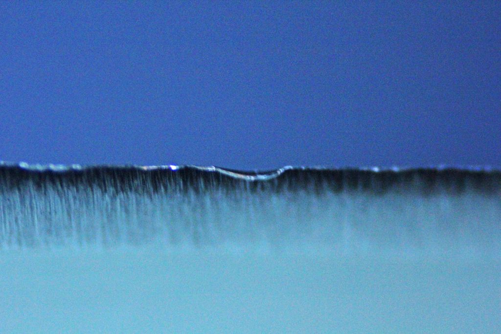

Well until I used it for a few easy kitchen tasks. The edge rolled on me after cutting vegetables(!).
That's not the worst tho'. It appears the wooden handle has shrunk and now it wobbles on the tang.
If that's not bad enough the handle started splitting too.

0lSTtHUp
8P0bGrO0
All in all pretty pathetic I guess. I heard many positive things about Bursa's knifemakers maybe I made a mistake by not buying from them directly but through a shop in Istanbul. But still. This obviously shouldn't happen. But oh well. On to the next!

I would try to re-sharpen the edge to see if it can actually take a sharp edge. Then i would use it a bit to see if the new edge would hold. It could be that the tempering was so poorly done that it is not worth the effort of trying to re-handle it. From the pic you posted of the edge after cutting a few veges, i think this blade is very soft steel, maybe Rc less than 40.
