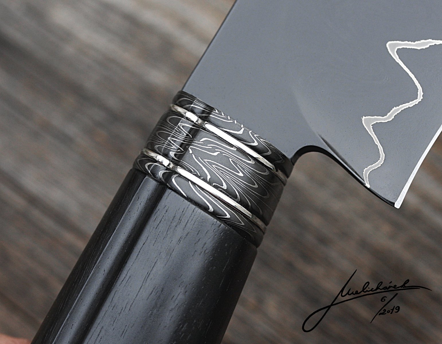

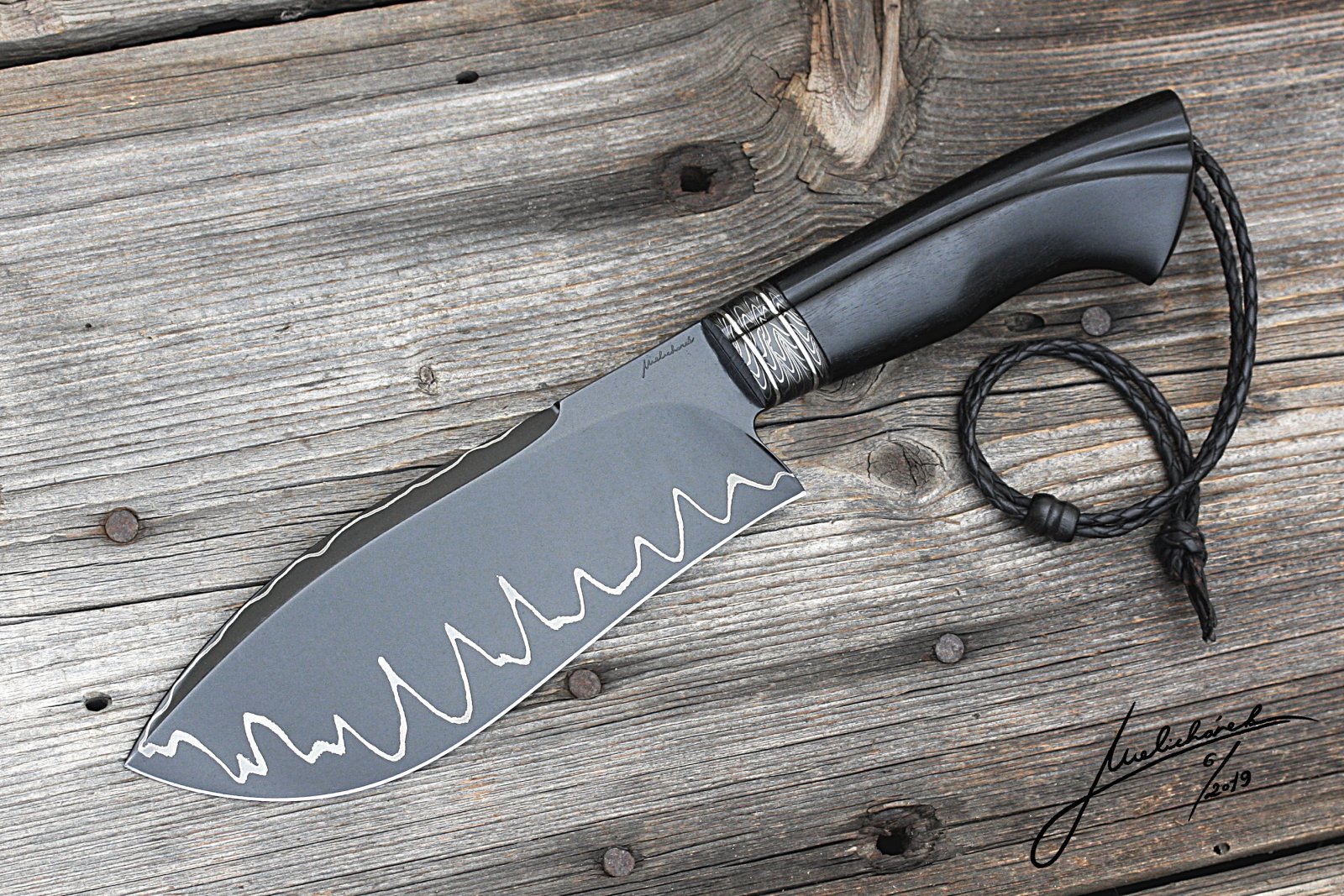

BORFAS

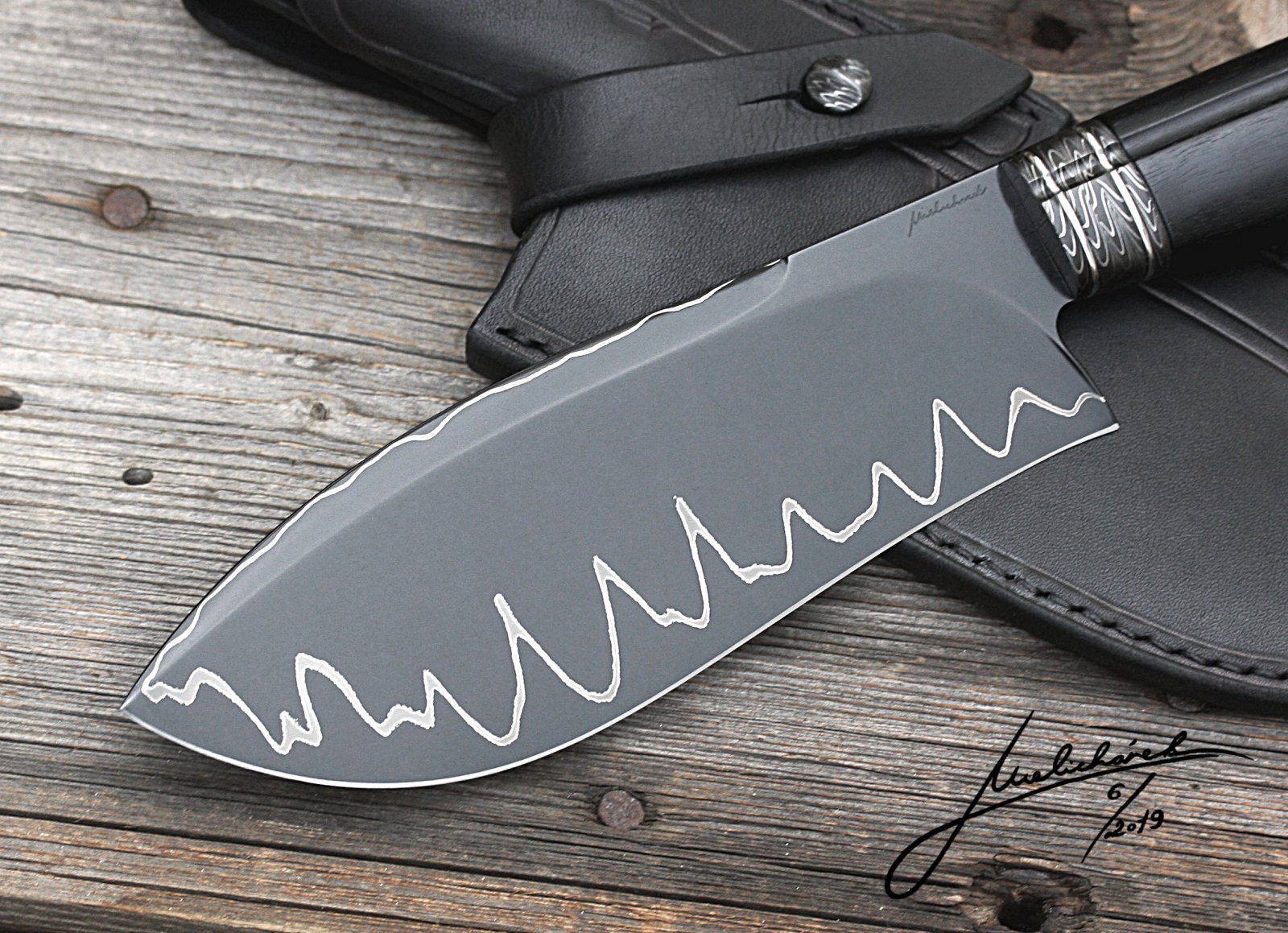

Blade - Laminated steel -5 layeres - 1,2842 (O2) + 75ni8 Uddeholm (15n20)

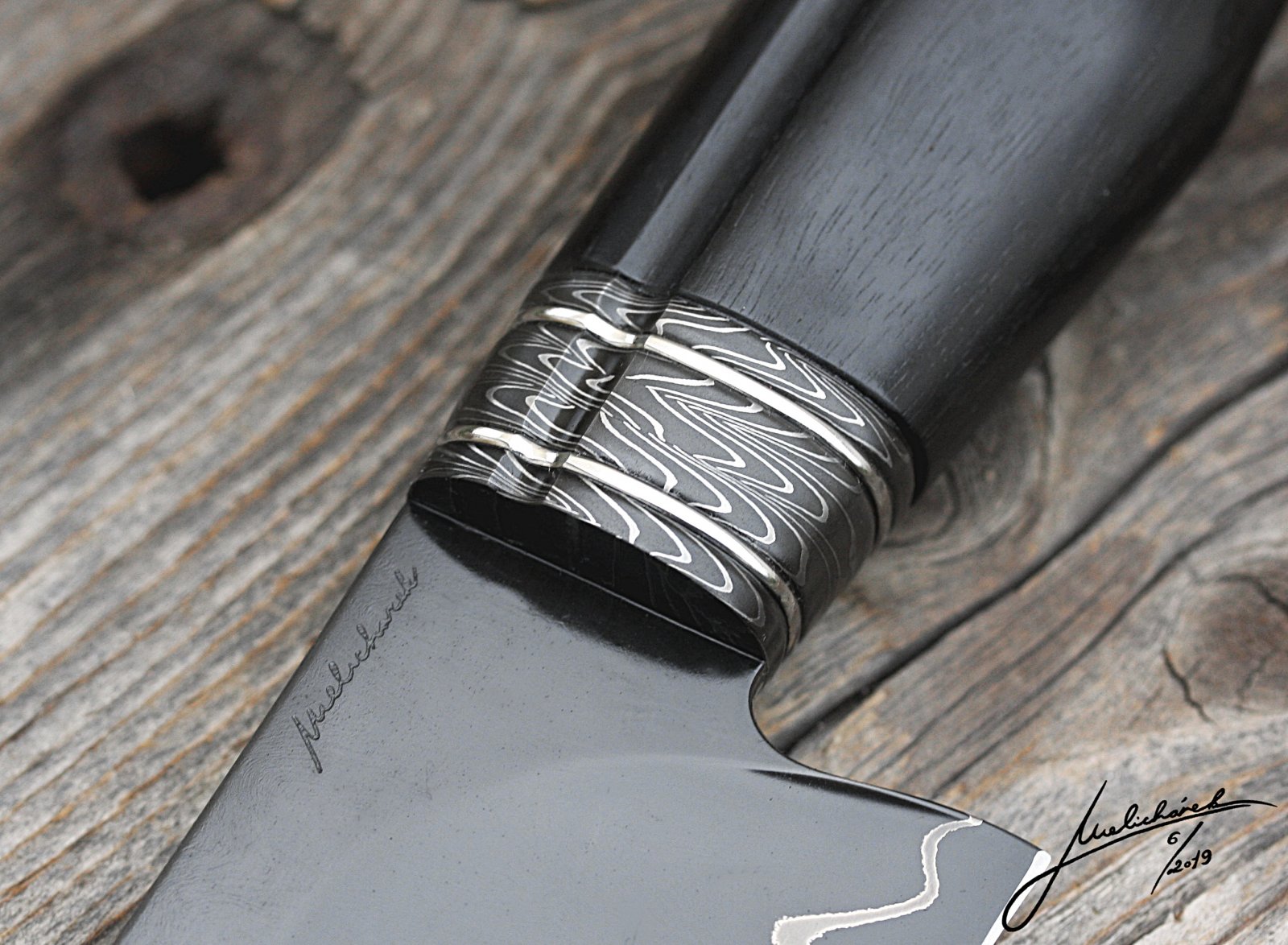

Guard - damascus - 1,2842 (O2) steel + 75ni8 Uddeholm (15n20), stainless steel spacers

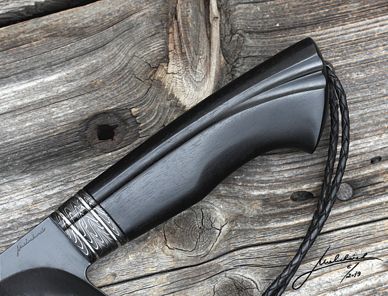

Handle - Ebony
Average length - 32,5 cm (approx- 12,8 inches) , blade - 18,5 cm (approx- 7,3 inches).
Blade width at widest point 60 mm (approx 2,4 inch ) mm , blade thickness 4,6 mm (0,181 inches).
