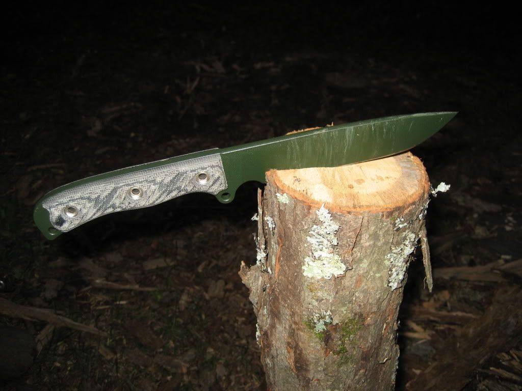

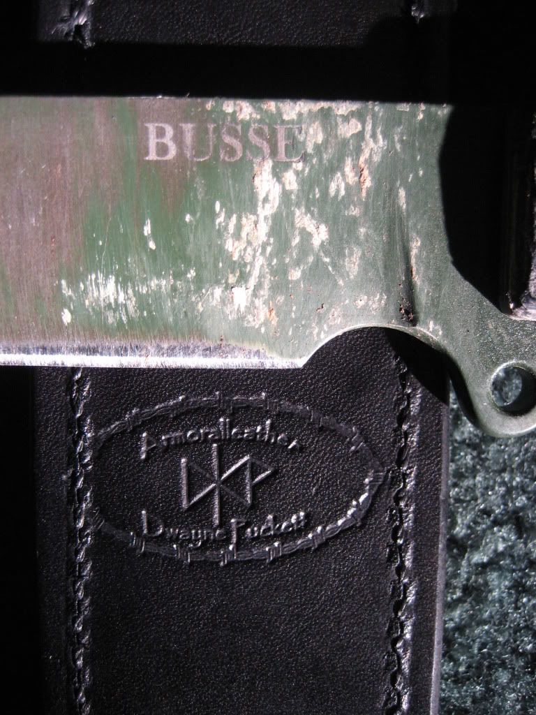

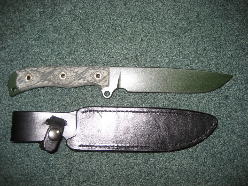

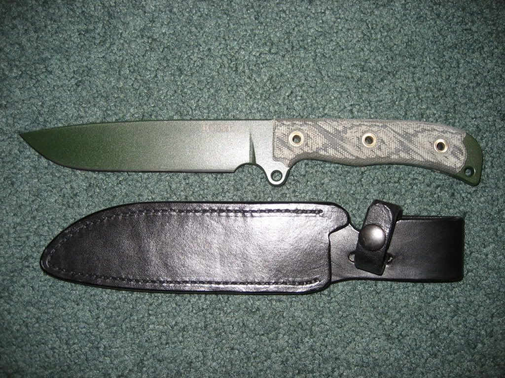

The BJ is an awesome blade I beat mine like I do my larger blades and it handled it with stride....here are some pics for you.

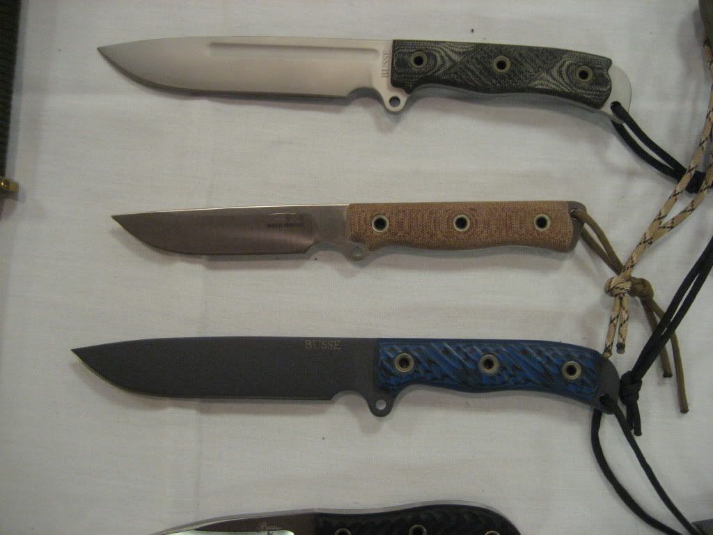

Here is another pic for you....Proto with black Micarta and CG with Blue/black G10
