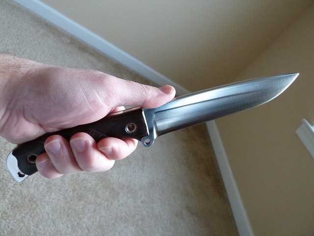

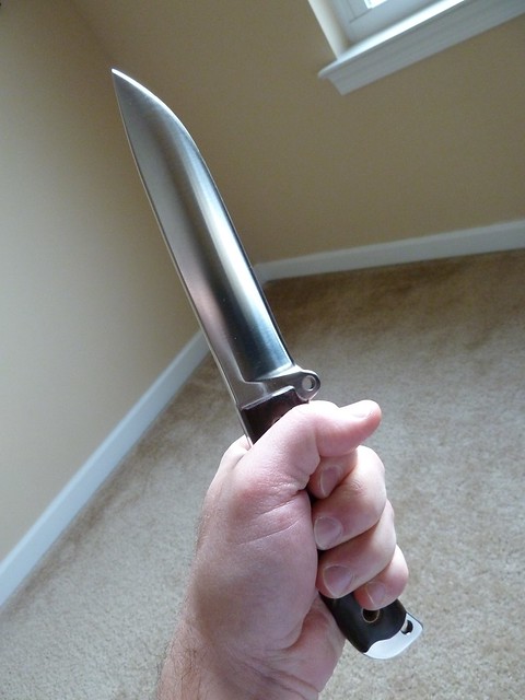

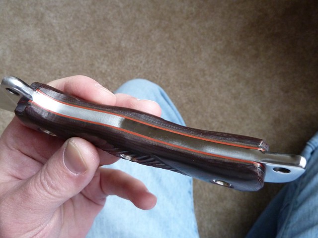

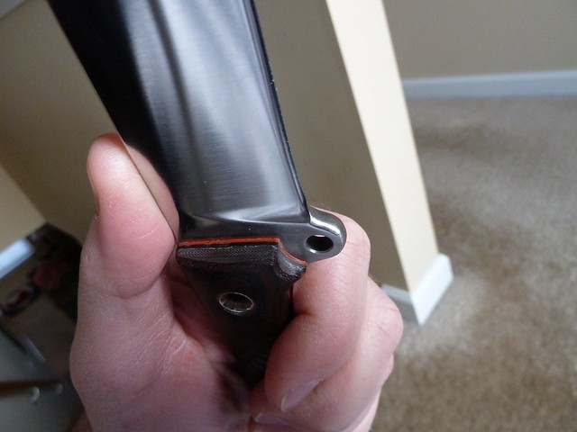

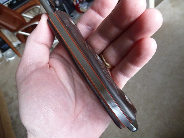

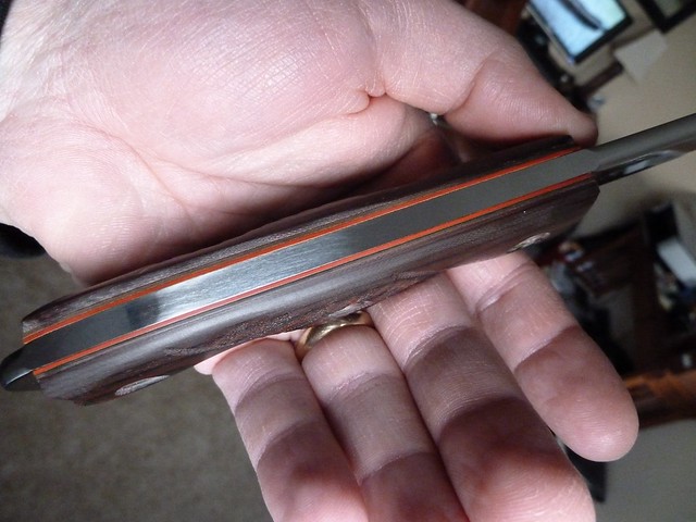

Answer: YES! Spacers do indeed work!
The thin Boss Jack handle issue (for my hands) solved by George (who also does work for Liu Kang).
He did an awesome job putting double-liners - black and cinnamon - on my Boss Jack. He did an incredible job, and the thickness is now perfect.
A few pics of my new, better-fitting Boss Jack:
Fills the hand much better now...

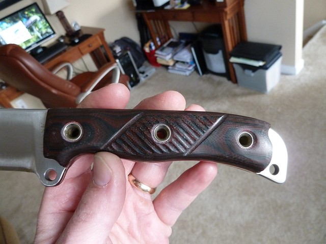

Compression handle fasteners put back on nice and tight..
I don't think I would have anyone but Busse put the spacers on especially if it is gonna be a user. They have the correct press for the hollow tubes not just a hammer and punch.
My opinion.
AFAIK, other folk don't use a hammer and punch, in all the tutorials I've read, people talk about using an arbor press or a honking big vise with flare jigs.
It is certainly true that Busse won't warranty the handle work when it's done elsewhere, but I would expect the modder to stand behind his work for any repairs.
A vice and deck screws can be used to re fit new Tube/Rivets.
There are several tutorials on here.
LightGuy, sweet pictures. I'm glad you like it!

The Boss Jack looks good

Nice looking handle - That looks like the BJ proto, which is also thicker than the new LE's
Thanks. Yep, this one is a Proto .220" like the new CG version. I like the thickness - gives it a good heft for a smaller knife, but I spent a lot of time re-profiling the edge to be thinner. It was extremely thick almost all the way down to the very edge before. It's much better now.
I'm assuming they thickened-up the G10 scales on the LE version to compensate for the reduced blade thickness. This one had a pretty thin handle even with the thicker blade.
Nice looking job LG. I wonder if it would have looked better or worse with the black spacers on the blade and the red between.
Thanks. It's hard to tell what it would have looked like the other way around, but I think I would have liked it better this way. The black on the outside blends in to the handle so it's really hard to even tell it is there. I like it because it just looks like there are single cinnamon red liners, which stand out really well due to the black liners next to them. I really like the way it turned out.
