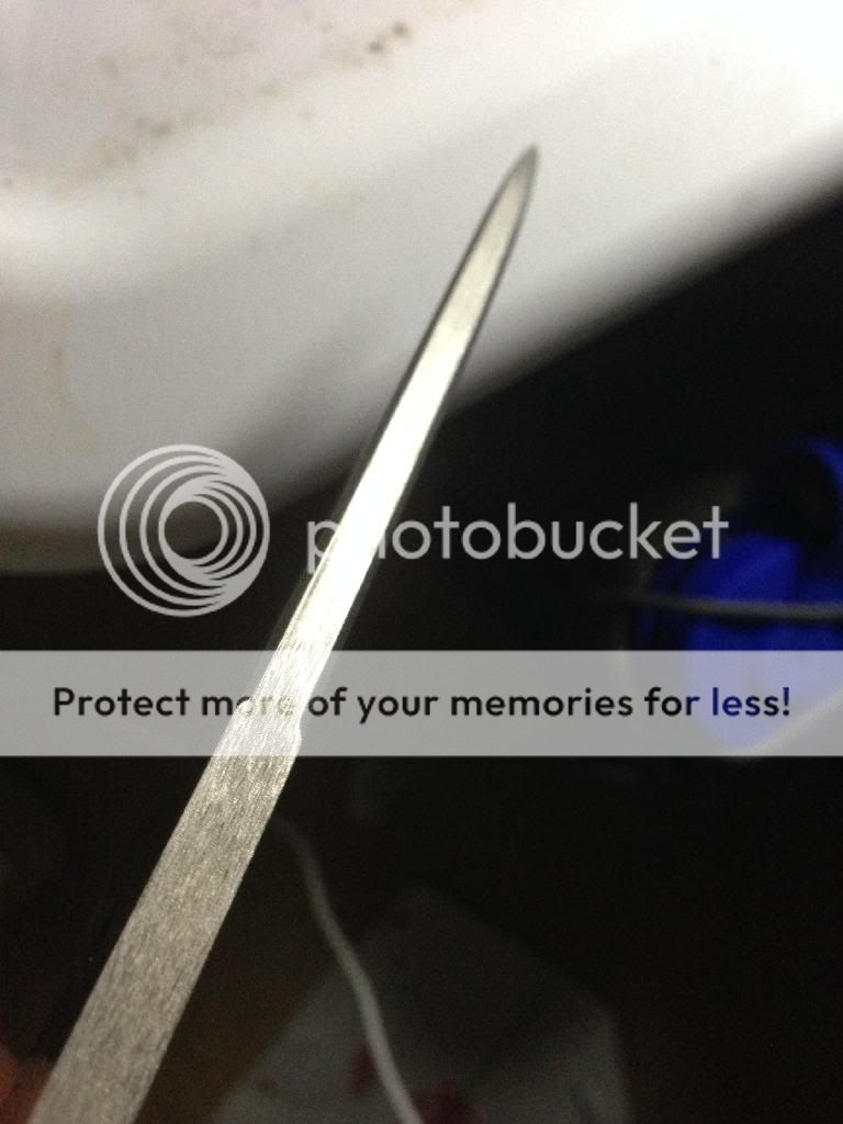

I recently bought a very well used Busse Boss Street in .22 inch thickness. I found it to be too heavy handled and thick for my ideal camp/edc/utility blade, so I'd like to modify it. I plan to remove 1mm of material from each side of the blade, then possibly skeletonize the tang to lose some more weight, followed by a satin finish, zero convex grind, and re handle. I plan to use the bevels on each side of the blade as a guide for symmetrical blade stock removal, which would leave the blade around 4mm thick with 90 degree edges for use with ferro rods. Is this a safe plan? Would it be faster to use a palm sander or hand sanding? I plan to use 40 grit sand paper to remove most of the material, and I realize it will be a lot of work. Any advice? Am I correct in assuming I will be voiding the Busse Warranty as well?
In this pic you can see the bevels I'm talking about.

And yes, your would void the warranty. Plus risc damaging the heat treat...
You might be better off to search for a Anorexic BOSS Street; only 0.15" thick, and it is already satin. Plus it was made in large choil, small choil, and choilless.

Taking 1 mm of steel off each face by hand sanding doesn't strike me as feasible. A palm sander might be possible. The right way to do it is with a surface grinder; Jeremy Horton modded a Busse that way some years ago when he used to mod knives. So you might be a able to find a maker, or a machine shop, that would do that for you. There have been a few posts here about drilling holes in the tang, the consensus is that drilling hardened INFI is a b***h. Go slow, use really high quality nitride coated bits, and be prepared to break a few of those.
