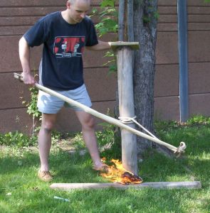

What about something like this:D
Found it HERE
