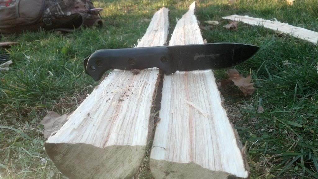

I've been reading the Traditional Bowyers Bible over the last few weeks.
I have access to some property that has hundreds of 6-10 inch walnut trees that are growing way too close together, so I thought I would try to find one "straight enough". I happened to be on the property last weekend and picked the straightest one I could, but it wasn't straight enough. This is my very first attempt at producing an actual traditional bow:
How does this fit in Beckerdom? Well the BK-2 was the tool for the splitting. it worked great.
First the stave and tool:
The first split, I started at the narrow end dead square in the middle and ended with this:
The split was happening well before the edge contacted the wood, which is what I thought I wanted. At this point I figured I might as well try to split it again, if nothing else to gain experience:
It was going well, but I could tell that this tree was not going to be bow making material:
The end result wasn't good, but not as bad as I though it would be, I will cut the worst twist off and once it is dry make a couple of small (32 inch) bows, just for the experience. I'm almost certain the tree choice is at fault here, not the tool. I haven't decided whether to continue to look for the right tree or just buy one for my first...
And a glamor shot, a great tool for splitting and so much more:
If anyone has experience with this, please chime in!
You might try taking the straightest peice and clamping it down (with a little induced reflex) to take the twist out of it. Keep it tied down as it dries, then when its done drying take it out and see what you have. Maybe try steaming the wood to remove twist. Good luck!!

From what I understand, Black Walnut is not one of the easier bow woods to start with. Eastern Hophornbeam (Ostrya virginiana) or Shagbark Hickory (Carya ovata) might be a better choice if it grows in your area. I don't have a lot of experience with bow making - 1-3/4 bows, so far. (the 3/4 bow just needs some finish tillering and has for the last couple of years :rolleyes: )

To answer your question though, you heat it up and then twist it back. You can go the modern way and use a heat gun or the old school way and do it over a fire.
Hedge apple (osage orange) is a much better wood to use for bow and falls right behind yew as best choice. Walnut is going to be a bit slow, but you can use it.
Also, if you back your bow you can get by with a lot. Making a 32" bow from walnut without backing it and making it very low draw weight will result in a broken bow, most likely.

Wow.. thanks for all the comments. I'll try to comment on a few.
I only used walnut because it is readily available... the osage around my woods is really, really crooked.
The short bows would be for playing with width, thickness and tiller experiments, I won't expect them to shoot at full draw or anywhere close.
The two longer pieces are going to sit in my basement through December and then I will try to start working them if they aren't dry enough then Jan or Feb. The book says 9% (if I remember correctly) moisture is best.
I may try to straighten the best one, however I still might buy something a little more suitable for a first build :)
