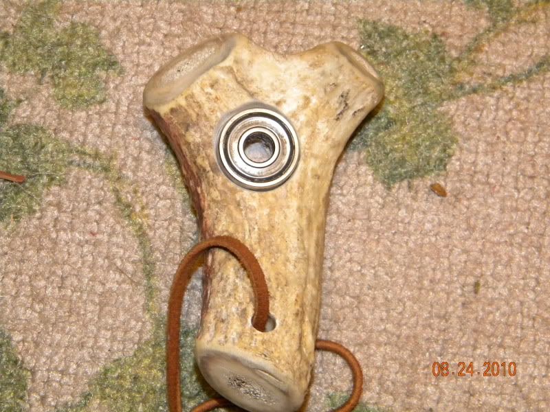

BTW centar metal is bearings? I couldn't understand why such one was attached in many cases. :(
I have a couple of knives with divots in the handles, but I made an antler bearing block a while back and use it a lot of the time now.
Looks like a large Ball Bearing bushing. Terrific idea! Build it in walking sticks or knives!
I don't think its cheating, if you are going to take the time to make a ready made bearing block then why not go the distance and make it as good as possible?
I should ask "What's this one such like a lanyard hole of Fiddleback?". :)
Thanks for sharing fine tools.
I didn't notice the meaning of bearing until my socket created very much friction. :D
I like any ideas from spits to bearings that ease works. Thanks for solving my question.
I've got one of hard maple, one of Bois D'Arc and one of cedar. The cedar one has the divot filled with beeswax.
I've tried the ball bearing. I'm looking for a suitable cone needle or roller bearing to try next.
Reason I went with the roller bearing is I had it on hand and was easy. Also a suitable needle or thrust bearing will be much more costly.

I still want to make one with the bearing. Most larger sporting goods stores have them in 3 packs at the roller blade isle.
