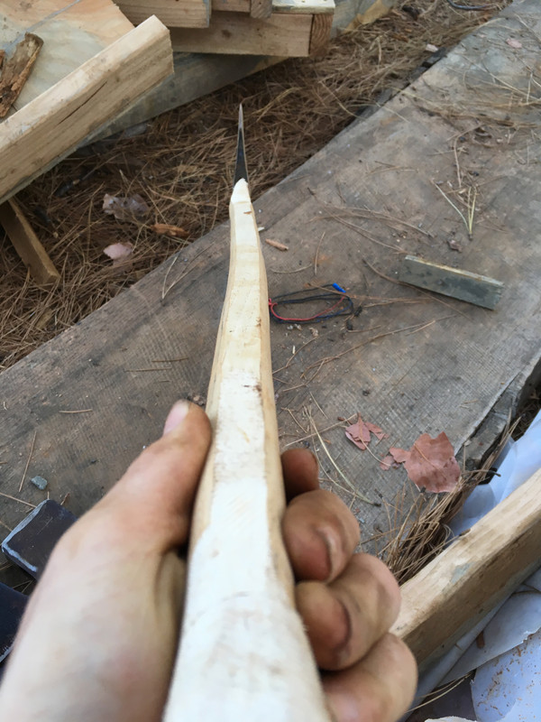

I got this Tennessee Hickory handle half way done when I realized it had a
bow in it. It’s now been clamped to my bench for about a week. And it’s almost straight again. I did not steam it or wet it. Just cold dry clamped.
My question is will the bow come back or should it stay straight?

It will definitely spring back eventually. Can you make and direct some steam? I've had great success using localized steam and weight. I just suspend the haft on some saw horses and attach a ratchet strap from the bend to something heavy. It's worked well for me! Good luck!
I knew it could not be as simple as I hoped. I’ll use steam. That won’t be a problem. This is good practice for me because i have a few old hafts I’d like to straighten.

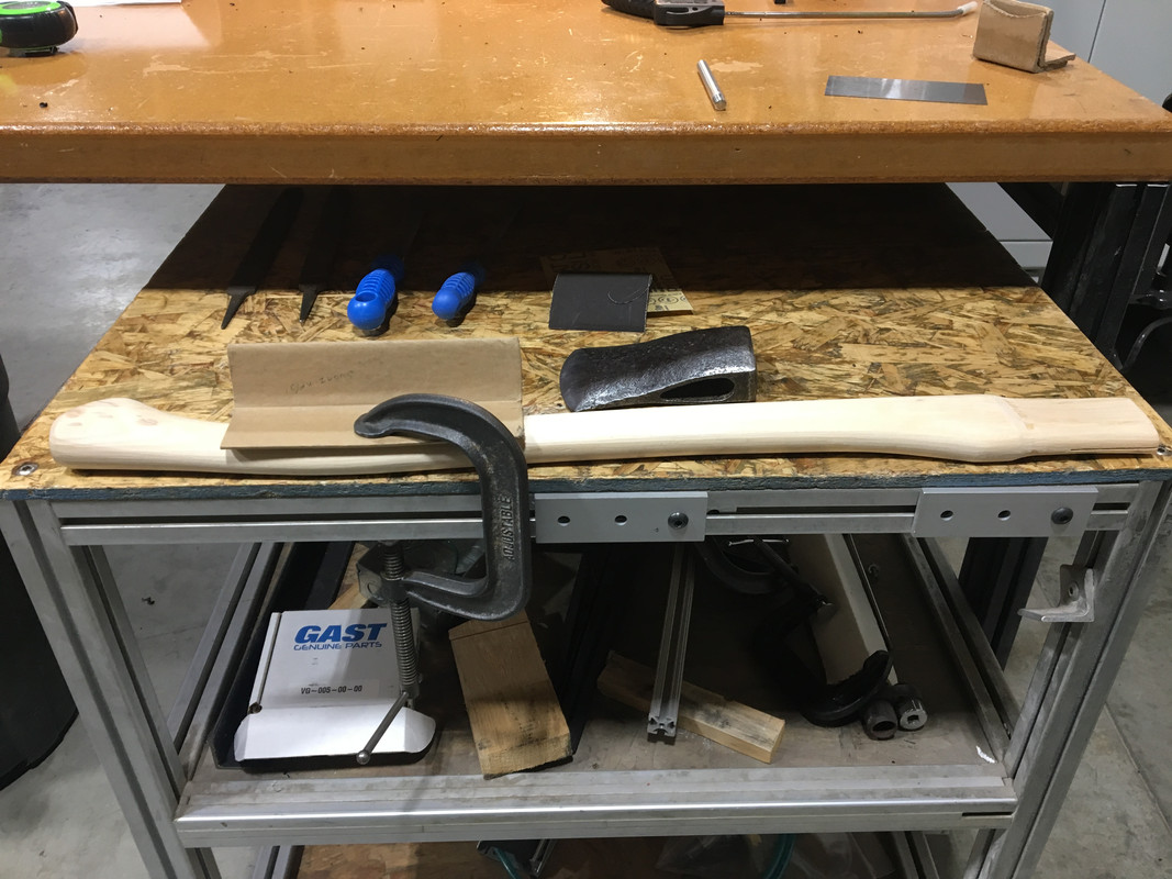

So what I’ve done so far is moisten the wood with warm water. Then clamped it an heated the haft with a heat gun.
Hot to the touch. How long (average)
Do I heat it and how long until I remove the clamp ?
I do realize some results may vary. And I may need to do it multiple times to get the desired results.

Ok so it did seem to work. I heated it hot to the touch. Then left it clamped until cool. Annnnd I went to far the other way. Haha oh well I’ll clamp it back a little the other direction.
I guess now only time will tell if the original bow will come back.
It was a lot easier that I thought. For some reason I was under the impression this process would take weeks for the wood to set.
Thanks for all your input

What I described above worked. Using a heat gun. Even though I went a little too far the other direction. I just flipped it and re-clamped it. A day later it looks great.
I’m very happy and now will dig through my pile of removed handles and see about salvaging some of them.
