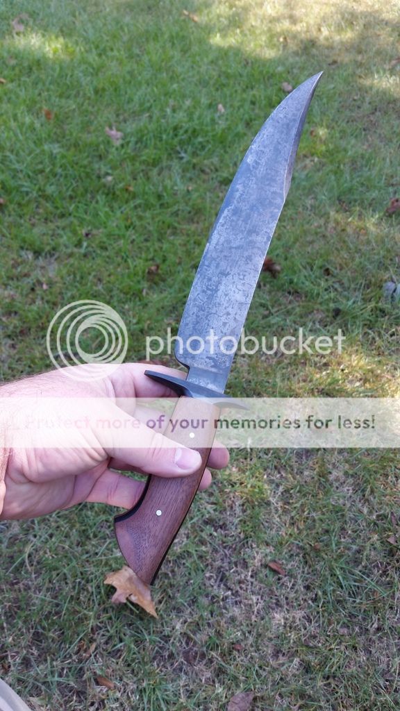

Been a while since I posted a knife on here...been on instagram making my fortune...kidding.
A while back a buddy of mine brought by some shrapnel from an IED in Afghanistan, wondering if I could incorporate it into a knife for him. He also specified a heavy patina, and that I try and use a busted M14 stock he had.

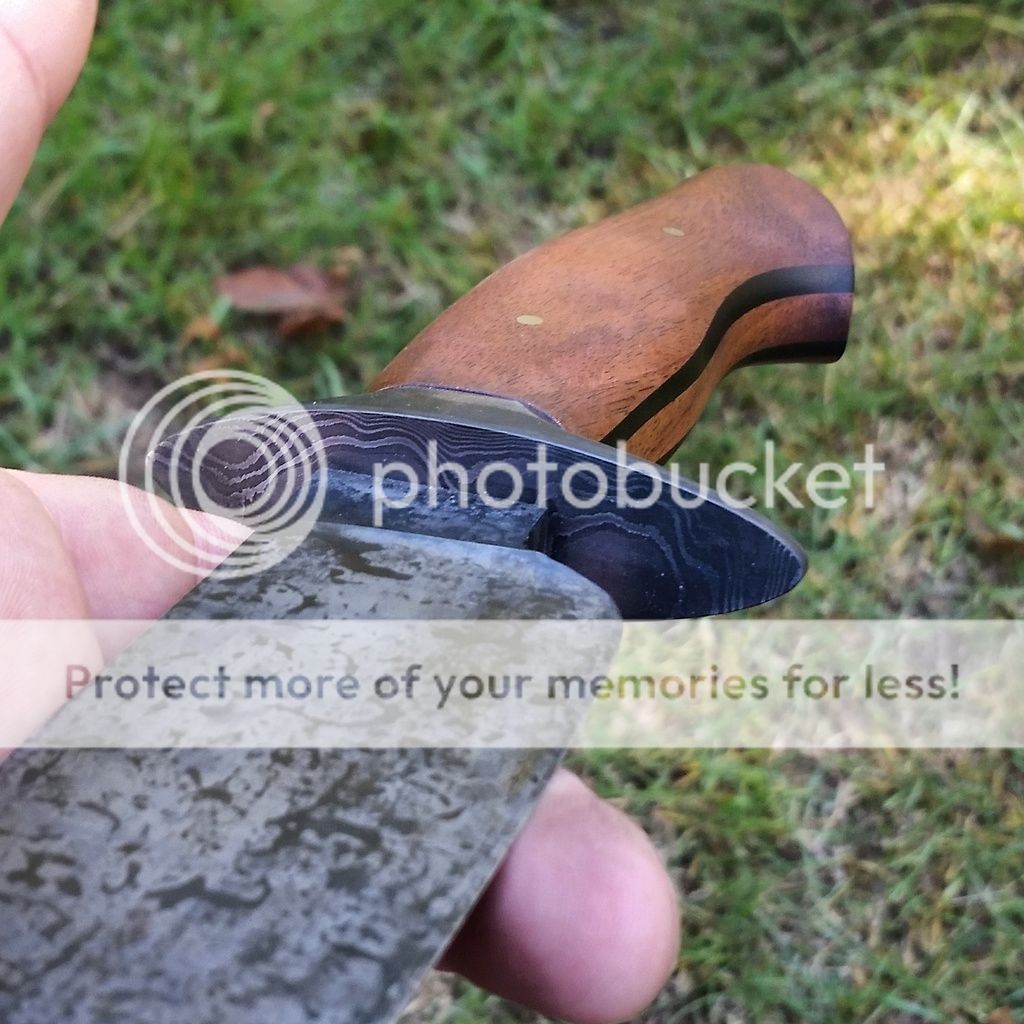

The shrapnel was cast iron, so I can welded it up with powdered steel and wound up doing damascus guard material. The gunstock was tricky due to the holes bored in from the butt end...had to get thin slices off the sides. Ended up laminating some carbon fiber with it for a block.
Here's what I came up with. It's a real cutter, and I know he'll get some use out of it.

Would love to see more pics of it from different angles
Thanks, guys!
Joe, I appreciate that!
I have limited pics, decided to put some more coats of finish on the handle and it's wet.

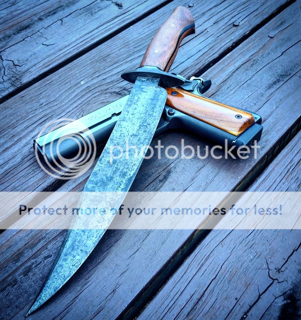

Here's a profile shot.
