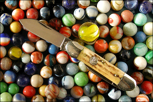

Here is a D2 blade that I removed the etch from
starting with 220 grit and worked my way thru the grits up to a near mirror finish.
