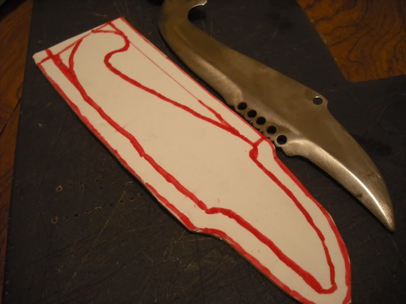

This is a bowie-style sheath I made for a kujang. The kujang is a radically curved knife of Indonesian origin. I made this for my silat instructor, as this knife is a traditional silat weapon.
I usually use craft foam to ascertain dimensions. This particular knife has an unconventional design, making welt construction challenging.
The welt is cut so the draw is smooth, even though the knife does not move laterally in the sheath.
