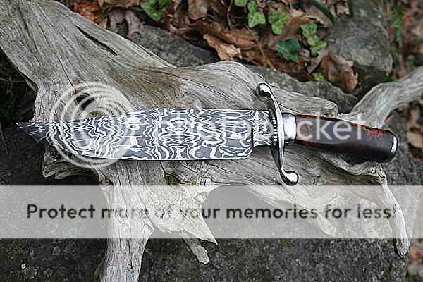

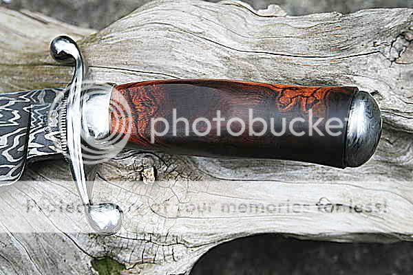

I wanted to give this Bowie a bold pattern so I used a low layer "W" with an accordion cut. The blade is 1084 & 15N20. The handle is ironwood w/guard forged from 416 and some blade steel for the pommel.

Very nice Gary!
Question.... have you considered submitting a knife in the ABS "Antique Bowie" judging at the Blade show? If not you should!

bobasaurus--The ironwood was drilled and then slotted to accept the through tang. The butt cap was drilled & tapped.
