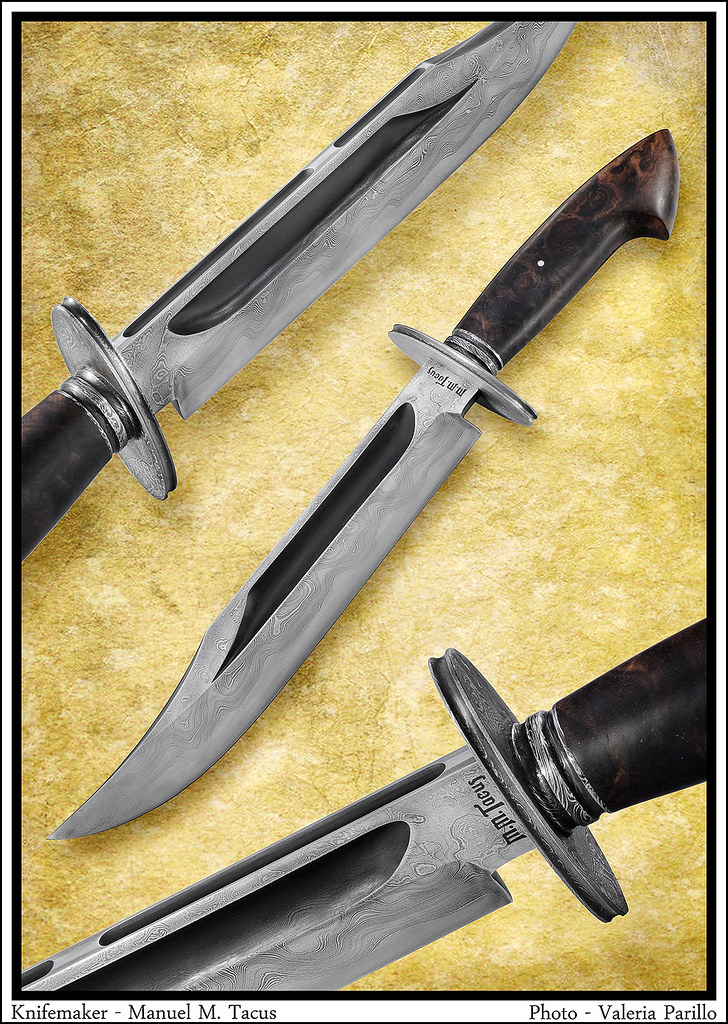

Hello Guys
this is one of two bowies with similar blades i finished last moth.
The blade is 10" long, San mai with 5160 edge and 200 layer random damascus on each side.
The wood is an argentinian Walnut stabilized on EEUU.
I made the grooves with my hanging lathe, polished with stones and sand paper to mirror polish and later they were fosfatised.
Hope you like it!
I replied to this post, but for some reason my response doesn't show, so, to repeat: it's splendid work on a classic design. Excellent!! You have serious talent!
very kewl looking knife. nice use of the grooves and color and overall presentation is very nice. Would love to see that one in person for sure.
