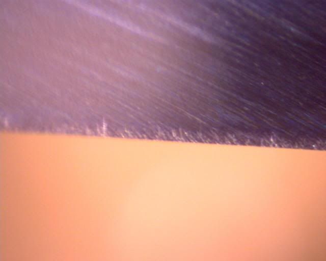

Here is a picture of a similar issue. Sometimes you can miss by just a hair and everything will look good but won't be sharp like it should.
Kitayama stone finish
At 200x the reason for the edge not being razor sharp is revealed.
And THAT is the name of the tune! Stropping should be the very last stages of the sharpening process. When I hear people talking about spending 2-3 hours with a strop it makes my eyes spin! I've been saying this over and over, but I guess people don't want to believe it. If the blade is ready for a strop, it shouldn't need more than 20-30 strokes... STROKES... not minutes. If you're spending more time than than, you need to use more stone!
