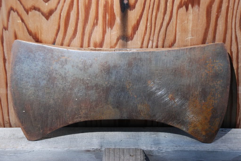

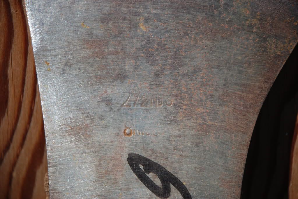

Here are a couple of finds that you might be able to help me identify. The first is the cruiser I picked up for $6. I wasn't too sure about it but for the money I was willing to take a chance. The stamps are light but I can at least say that it shows the weight "2 1/2" and below it a number 8 and some letters... I and pretty sure it starts with an "M" have you guys seen anything like this?

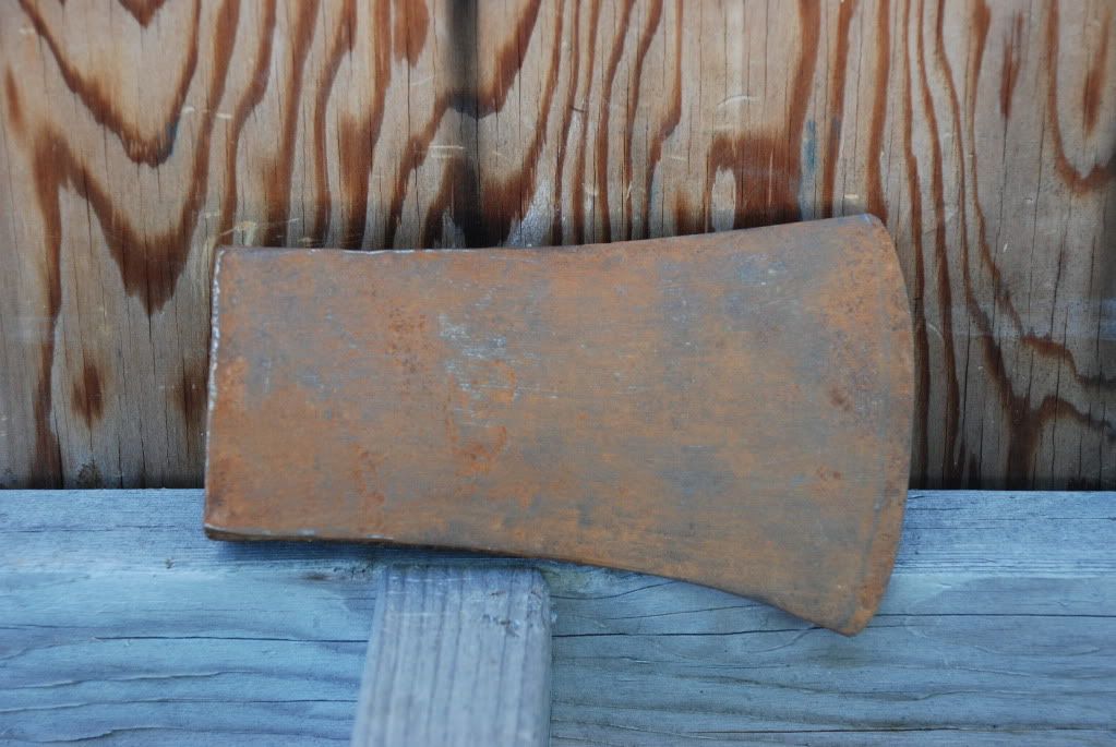

The next is a boys axe that I picked up for some change, literally. It has these ridges in the eye of the axe and no markings that I can find, even after a vinegar bath. The ridges seem to have a sharp edge toward the poll, maybe to keep the eye from shifting forward on impact? I haven't seen anything like it, and was just wondering if any of you have any experience; is it worth fixing up? Also, it seems like I might have a heck of a time trying to hang a handle with those teeth... Thanks in advance for your help!
A number of makers added ridges inside the eye. Without something more it would be difficult to identify.

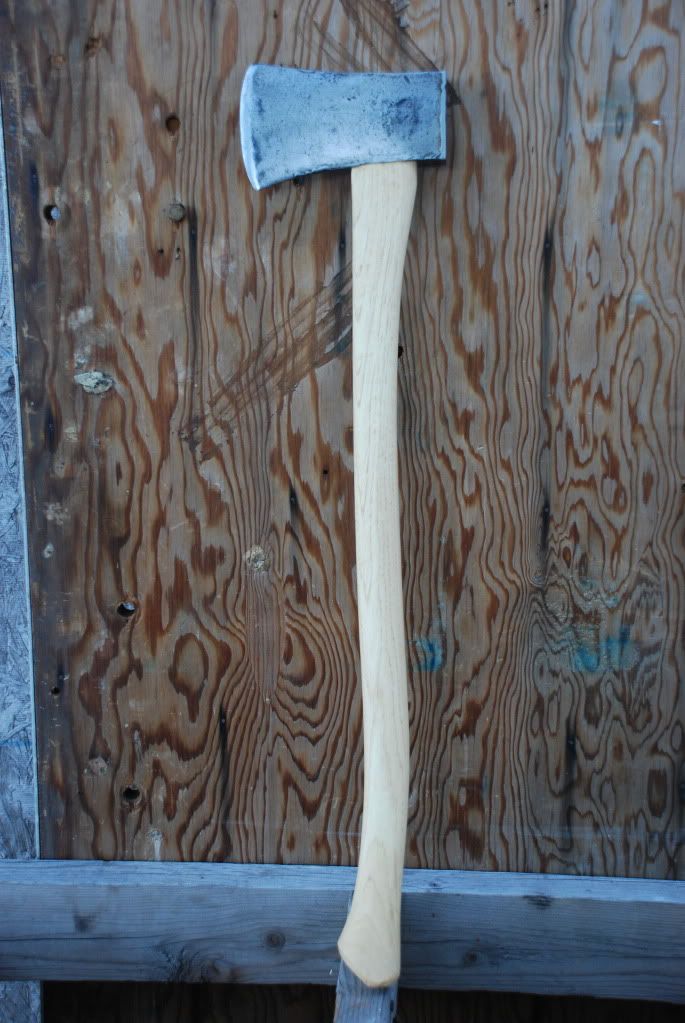

Well, I got a little impatient, and since I need some practice hanging axes before I start working with some of my nicer heads, I thought I would put the boy's axe together today.
After a vinegar bath/ sanding, sharpening, and a new handle from the local hardware store, here is the finished product;
What do you think? This is one of the first axes I have hung, and I have already learned a lot. Made a few mistakes with the wedges; I didn't thin the wood wedge before I started to drive it home, and when I put in the steel wedge the wood wedge sunk a little.
I am open to all suggestions.

Part of the trick is removing enough but not too much material from the handle (part inserted in the eye) so the axe eye slips on fairly easily. A few knocks on the knob end of the handle should seat the axe before wedging.
You will know if more material needs to be removed, if the kerf closes up like this:
It should be open.
Remember the axe eye is larger at the top than the bottom so adjust accordingly. Also trimming the wooden wedge is a must. If there is a lot of handle sticking out of the top of the axe, I usually remove some before wedging.
Linseed oil soak is a nice last step but it will not fix a poorly fitted wedge. Make sure the wedge is driven really, really deep.

i have several of these boys axe heads with the ridges in the eye. no markings. excellent steel and one of my favorite sizes . you did good if you got one for change, i have paid as much as $7.00 for one.
the cruiser is a real find. worth way more than what you paid. you might find it to be your go-to axe because of its smaller weight and size is real handy for all sorts of chores in the woods.

Buzz, you were right so far on the boy's axe. I wasn't sure what to expect, but after some further sharpening and honing, that little thing turned out to be a great little axe, if not too pretty. I used it to limb up and fell a little mulberry tree that was growing to close to one of my out-buildings. It made quick work of it.
And it doesn't hurt to bevel the top edges of the wedge before you drive it so that it's less likely to split. I've cracked an eye while driving the wedge before but I blame that on a bad heat treat. The eye shouldn't be brittle.
What is the best way to trim the wedge? It seems like it would be prone to breaking/ cracking if I tried to wittle on it too much.
A fine tooth pull saw works best for me.
Just curious, if you don't use a metal wedge, do you glue the wooden one? Or is the whole thing friction fit alone?
I will often apply construction adhesive to the handle and into the eye before final assembly. I'll squeeze a little into the kerf for the wedge, too. More recently I've started using a generic version of Swel-Lock on the haft and wedge. Also, letting the axe handle protrude a small distance through the eye, like 1/4", helps to keep the head secure. The wedge is wider in that last 1/4" and if the handle starts to slip at all it is quickly stopped by the wedge. Make sure your handle and wedge are both bone dry.
