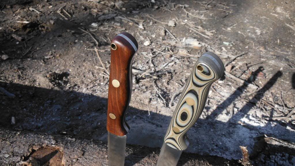

I have taken off the scales and redone more than one Bark River.
I can assure you that the older Bark River knives used pins, not just for antlers or exotic wood. I have knocked out the pins on G10 and Micarta handled Bark Rivers. I haven't bought any Bark Rivers lately, but I did get one or two after they switched to corbys and they were a PITA because they had to be drilled before knocking them out with a punch, so I know for a fact they have used corbys. On the half dozen or so Bark Rivers I have seen the hardware has been stainless or brass. They do have micarta pins on a few of their knives as well.
Thanks for the detailed answer Jhansenak47. My Bravos are from late 2015 to present . I am thinking they are corby bolts as I read on KF about all the "recent" bravos with synthetics having them. Even if I am wrong about that , I'm pretty sure they are on there solid. Thanks for the pic also.:thumbup:
