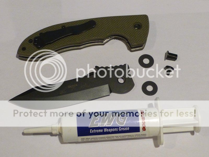

Totally normal. No worries. Take the pivot out and clean the action. Put a light coat of synthetic oil or synthetic grease. Readjust the pivot and you won't believe the difference. I do all my knives like this. It takes me 20 minutes and I do it slow and enjoy the process. A newbie will take maybe 45 minutes. FYI, If you dont keep track of the assembly order, the small washer goes on the blade side with the writing. The lock up will take care of itself.

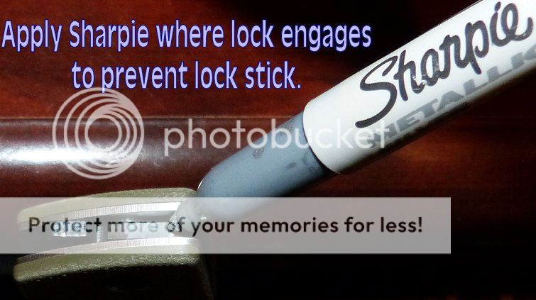

and apply sharpie to lock face to prevent lock stick from newness.
Yeah, it's already been disassembled. Didn't really help, although there was quite a bit of nasty looking grease.
Just disassembled it again to be sure the washers were re-installed correctly... they're definitely identical.
I'm gonna try adding some synthetic oil and see if that helps at all.

Use a Sharpie on the lock face of the tang and wave the knife open. After a bit, you should see the locking liner seat itself on roughly 50% of the tang.

I do this...... I also recommend a sharpie marker on the lock face. It takes the stickiness away instantly. I use a silver one and you cant see it on the lock face of the blade.

1. Disassemble knife and wipe away factory sludge.
2. Apply new synthetic oil or synthetic grease.
3. Apply sharpie to lock surface of blade.
4. Reassemble.
5. Tighten pivot a bit more than desired.
6. Open/close 100+ times.
7. Disassemble, clean, re-lube, and reassemble knife.

I open and close mine with the factory grease for a couple of days, then tear it apart, clean it out, and re-grease it. I feel the grittiness you feel when it's new is supposed to help break the knife in faster. It's worked for me so far
