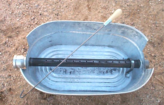

How much are you wanting to spend?
Knifemaking is a VERY expensive hobby but you CAN do it with minimal tools as well. I built my first charcoal forge just like this one
and it does well for heat treating 1084 and 1080 steels. I just used a hair dryer as the blower and lump charcoal from walmart.
There is alot to making a knife and a heat treat oven is pretty far down the list. I would suggest that you send your knives out for heat treat. Look at the stickies and see about getting a copy of $50 Knifeshop and that will get you going pretty well. The stickies will help select steel, let you know what tools are needed and alot about techniques. If you really want a oven Paragon and Evenheat are the tools of choice.
You can save 1 or 2 thousand $ by sending it out for heat treating.
