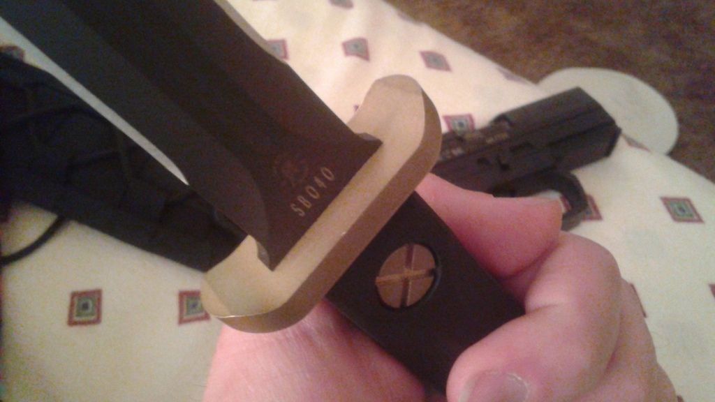

On my new Spartan Ek the brass legacy guards are a matte finish no shine and I guess that's the look they were going for with this dagger but I'm very curious if there is a way to put/get a shiny finish on these matte brass guards if I end up deciding I'd like that? Does anyone know if that is possible to do? Here is a pic of the new Spartan Ek brass guard..

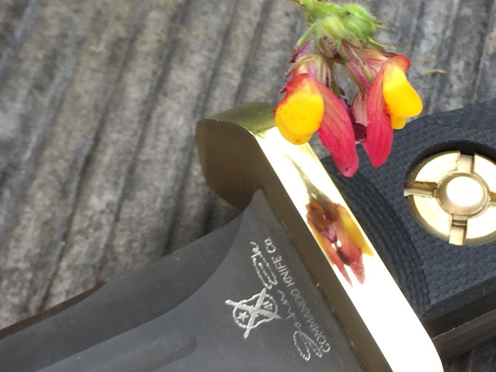

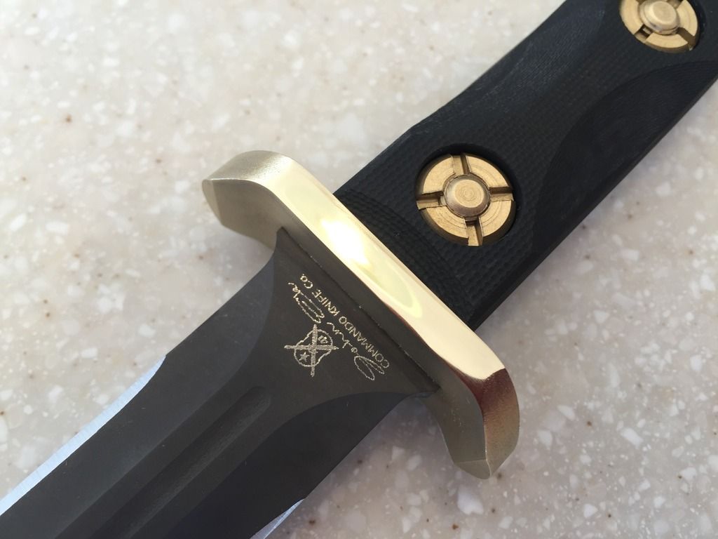

Well, I'm supposed to be doing yard work right now, but this seemed like a fun little effort.
I couldn't find my Simichrome so I used Pol metal polish. It's something I've had around for about 15 years. Still seems to work.
First, I polished the guard with just the polish. It brightened up pretty well, but the beaded texture still showed through.
Next, I tried some 600 grit paper. Made things much nicer but still saw some of the beaded pattern.
Went to 320 (a big step, but all I had). Still a small amount of the bead blast pattern.
Went to 220. That did it. Then up to 320, and 600, then polished. Looked pretty decent. Had some 1500 grit paper (another step that was probably too big). It seemed to refine the scratch pattern a bit more.
Then a final polish.
I'm a flat out novice at photography, so taking pictures of "shine" was kind of difficult. Tried to emulate some examples I've seen here.
The first picture is just trying to show the "shiny-ness". One can see the bead blasted parts of the guard on either side of the flats for comparison.

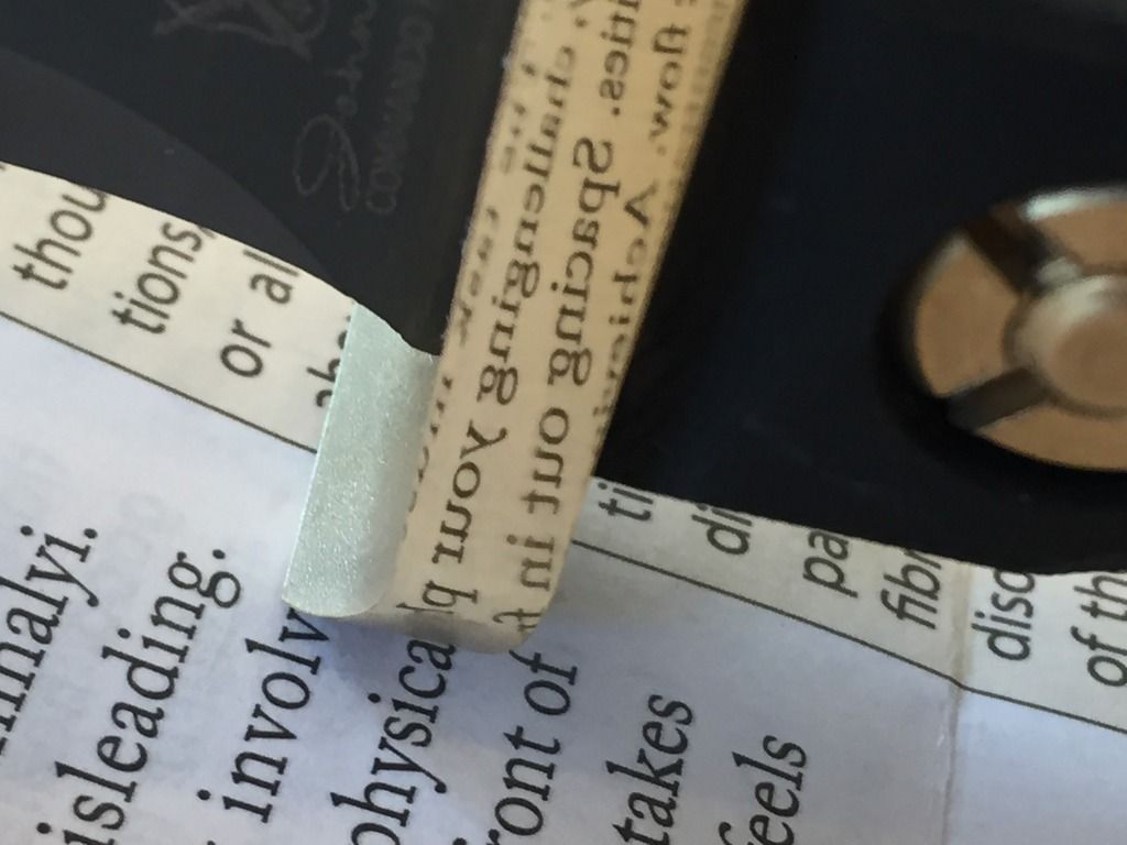

The second picture shows the reflection of some newsprint.

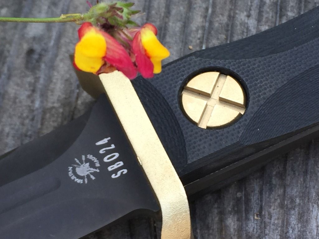

The third picture shows the reflection of a small flower.
The last picture shows the unpolished side. Notice there is no reflection of the flower.
This mostly shows my willingness to to avoid pulling weeds. I'm sure someone more adept could achieve a better polished surface and probably more quickly. I just used paper and a flat backing. I like the shiny stuff also, but if used as intended, the mat (sp?) finish is more appropriate. Now what to do - back to the mat finish or polish it all? For your entertainment. Mike
Oh wow Mike you did it! You absolutely answered the question as to if the guard can be brought to the vintage style polished brass! Awesome man that side you did looks really nice and yes good question as to keep it polished or back to the matte blast? Really cool
