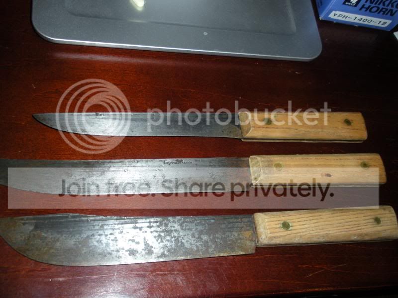

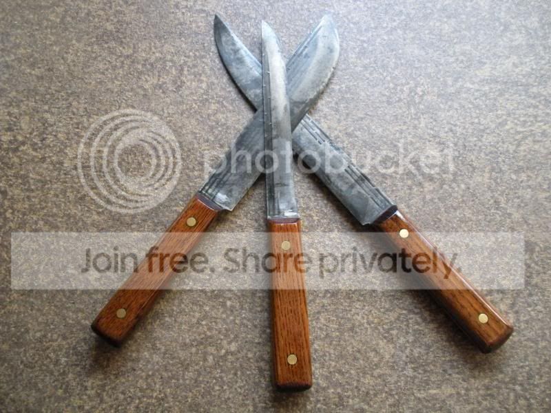

These are the original oak handles, unstabalized, from probably around the 1950s. I sanded them down, stained them with Birchwood Casey Walnut stain, and finished with Tru Oil. These handles have lasted this long, through storage and countless washings and they're still as tight as new (save for one has a TINY amount of movement).
When I started the project after a good washing and scrubbing with a scotchbrite pad:
