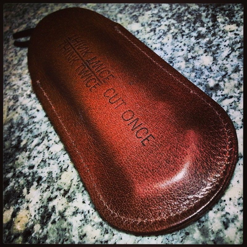

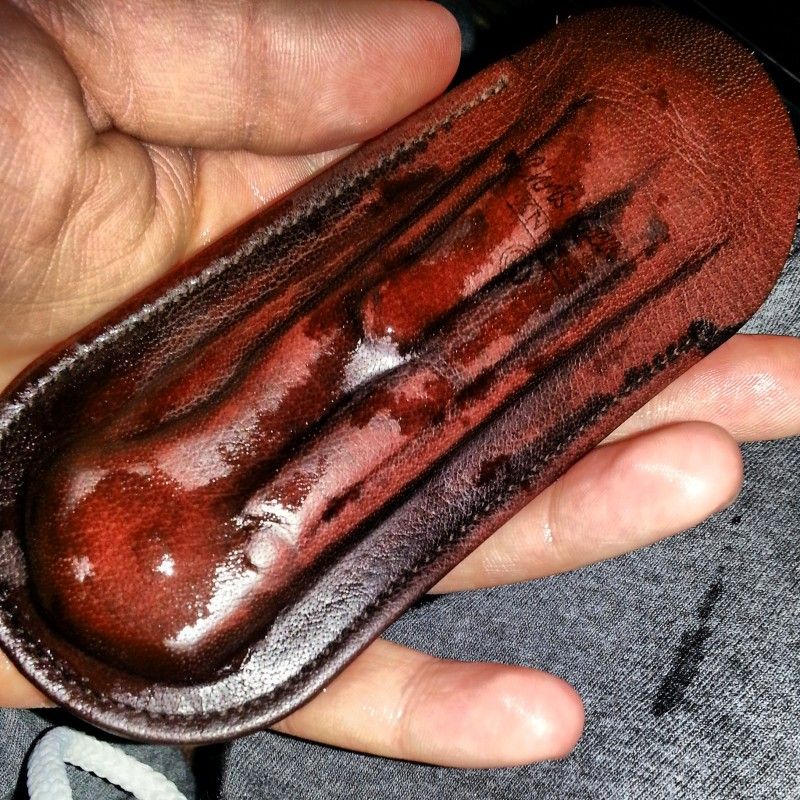

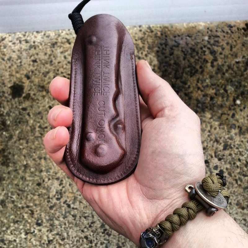

If the knife has wood inlays I wrap it in Saran Wrap, if Micarta I just go to town on it. I moisten the leather with my fingertips, but I don't soak it. Basically I dip my fingers in water and massage the sheath around the knife. It will instantly start to take form. As it dries the leather will shrink and show the definition of the knife more. To get the lines exact and distinct I use a bone creaser I've made and any other random tools that can get into the nooks and crannies of the knife. It usually takes about 3 times of lite wetting and rubbing with the creaser and drying but thats it. I've used a blow dryer, a heat gun and a space heater to speed the drying process along but none give better results over the other. Even air drying works the same for me. Thats it. Like JNewell I've probably done this to a dozen or so sheaths and they all get the same results. I've supplied pics of the different stages so you can see...
If anyone has any questions feel free to ask. If I take forever and a day to respond forgive be but I've got a health thing Im trying to get through and spend most of the day sleeping recently. Hodo can attest that normally I move pretty quickly but lately everything is at a stand still.
