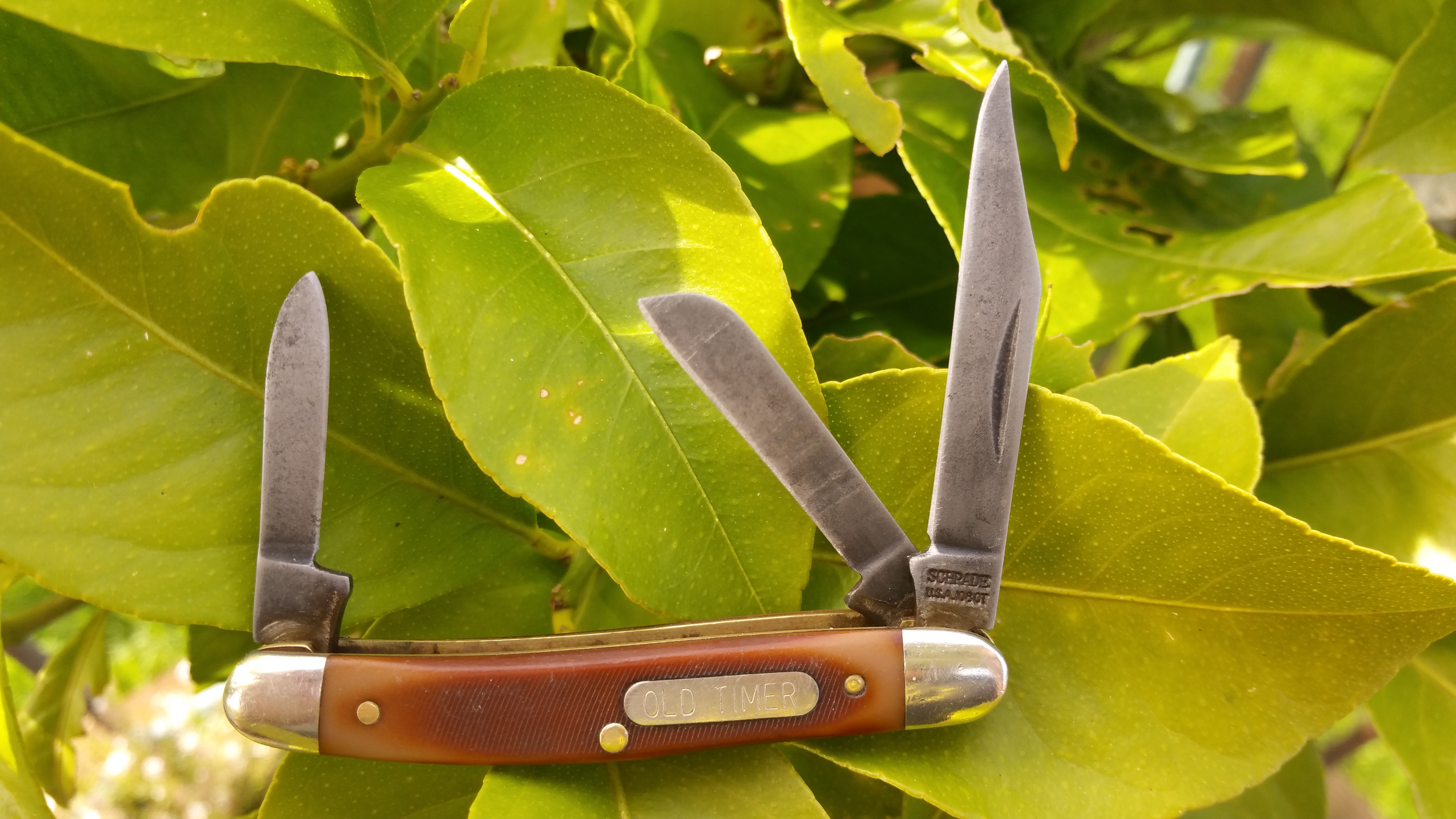

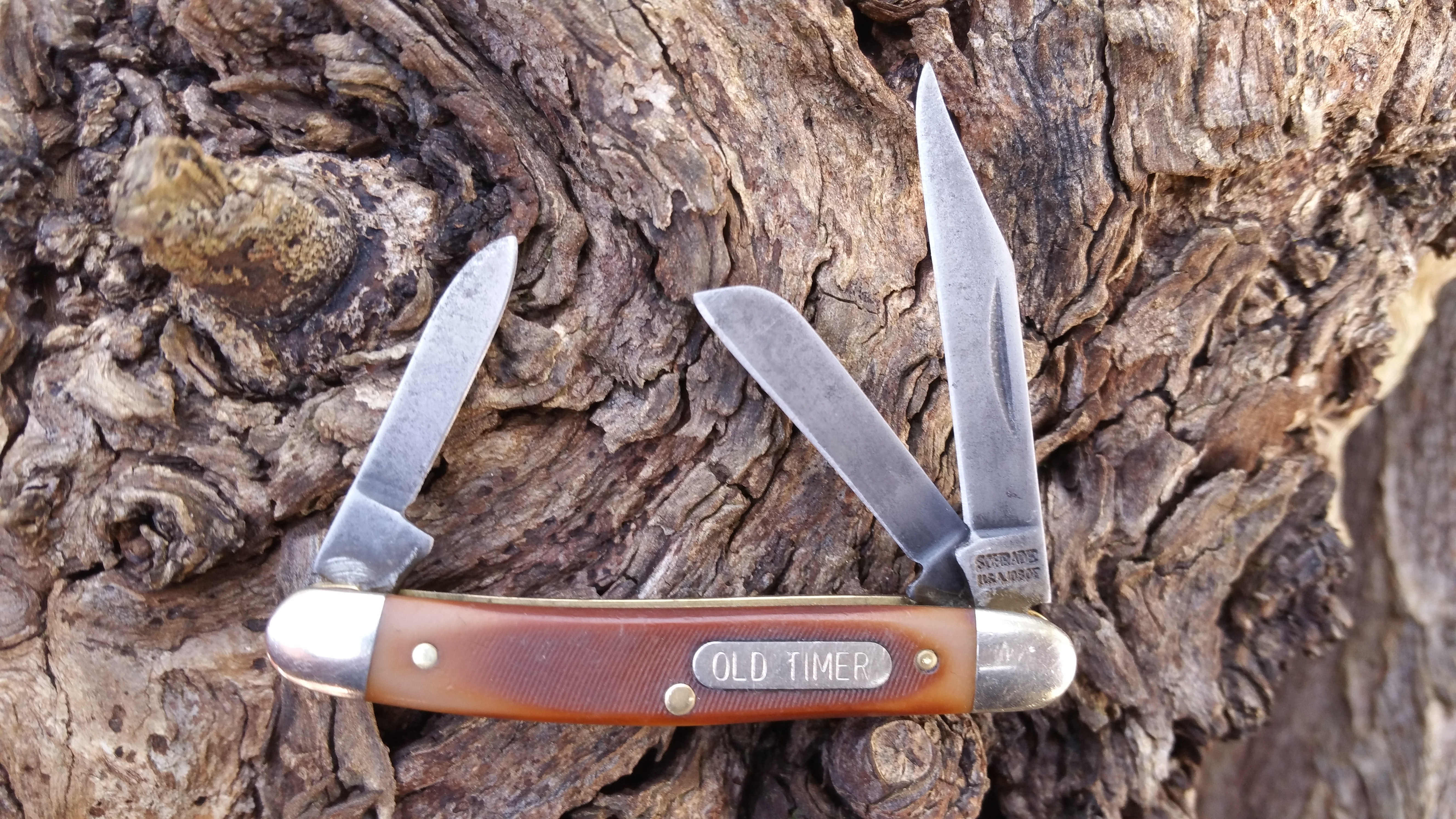

Tomorrow I'll get some nice "after" pictures in the daylight.
