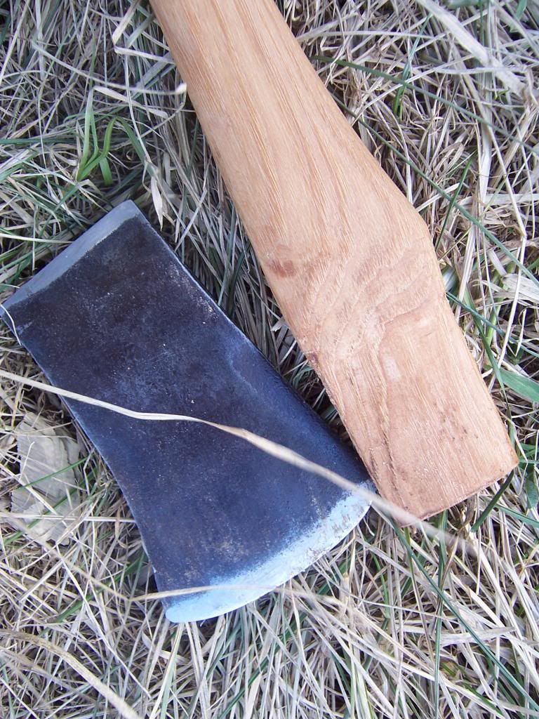

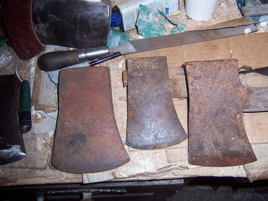

Picked this up for $8 recently. Nice profile and maker's stamp:
Cleaned up with wire wheel:
Hung on a 28" boys axe handle from "Do it Best" hardware:

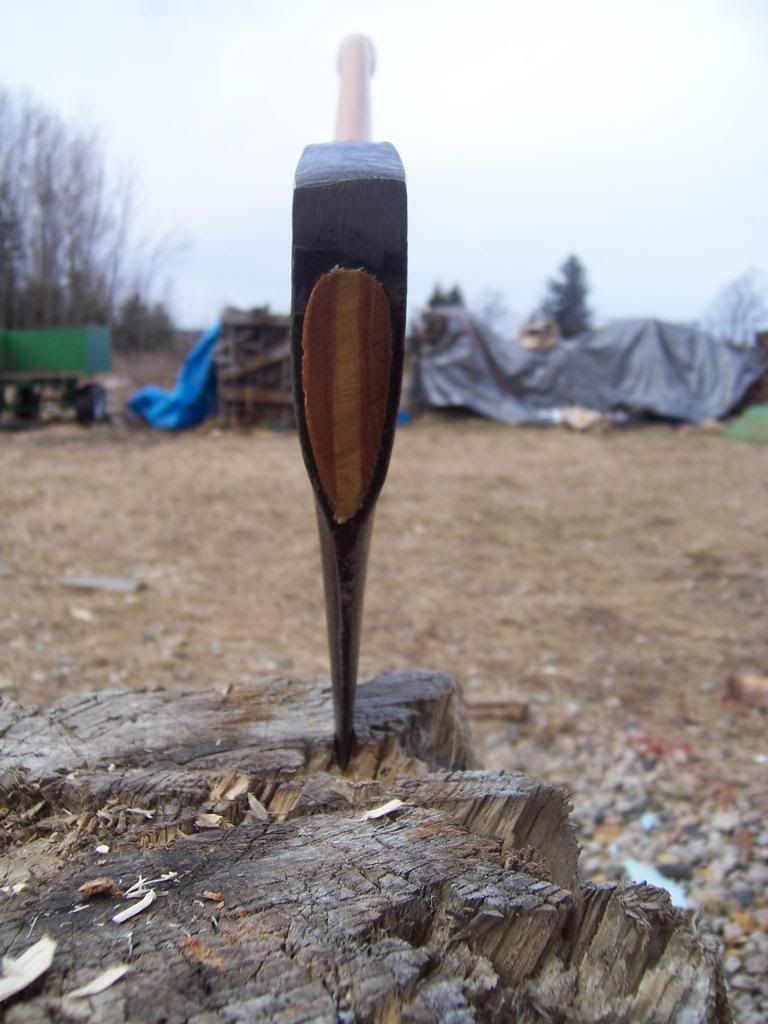

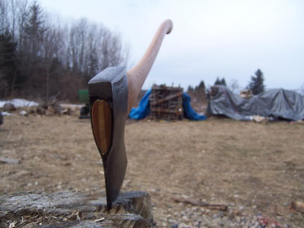

A sweet profile on this one. Thanks for looking.

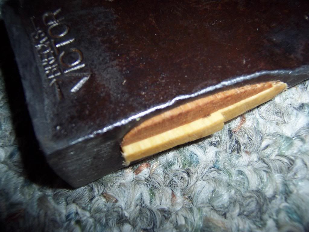

Here is the pic. I did a bit of chopping yesterday and came in this morning to find it like this.
Wondering if I should drill it out and rehang it.
Looks like you might be able to just pull the wedge out and save the handle from a drilling, if you want to keep it intact. Not sure if it's necessary to redo the hang, but it seems pretty likely. Perhaps dropping the head a little lower on the shoulder and leaving the top of the handle a bit proud, with the wedge.

With that axe I'd try just driving the wedge in deeper. Do you have a scrap of 3/16" thick steel stock that you could use as a punch? Or maybe a suitable bit of hardwood to make a temporary punch out of?
Well, this axe works do darn good to live with a half-assed hanging. So.. i drilled out the wedge:

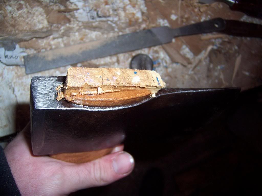

cut the kerf a bit deeper; rasped, trimmed, and spoke shaved more off the shoulder and handle; seated the axe further down; used swel-lock (sorry Peg, I splurged for the brand name); drove a larger wedge home (note blue specs from painters tape holding my wooden mallet together):
edit: I did notice gaps on the bottom eye between it and the handle before. These are all filled in now that it is seated lower and a larger wedge is in (i think)>
