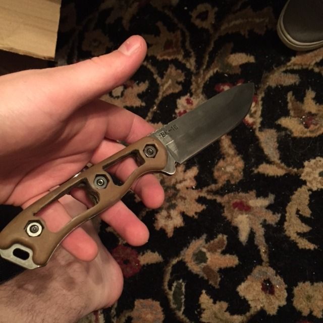

so I had an idea for that extra set of tweener handles they all come with.
Now I'm not saying it was a good idea but still, its something I haven't seen before.
with out further ado, I give you skeletonized handles for the skeletonized blade!
For the ultralights that just can't stand that extra handle weight holding them down. haha
I have no idea why I thought about trying this, but it just hit me yesterday and I had to try it out.

I love seeing people get creative and try new things. For that I thank you. However, I cannot imagine that it reduced the weight much nor can I imagine it being any more comfortable in hand. It came with two sets of scales so there was no harm in trying it out. :thumbup:

How did you do it?
If you want to save more weight, put those scales on a production FFG BK16 instead - higher grind means less weight. ;)
aaahaha! That's cool!
How did you do it?
Well it was a bit tricky. I first screwed on one of the scales to the knife and drilled a hole in the center of the skeletonized holes.
Then I took it to the scroll saw and fed the blade through the hole and used the blade as the template.
It got tricky when I found out the scroll saw was moving so fast that it really wasn't cutting, it was melting through it.
So even when I went around the whole thing with the saw, it would reseal itself back together.
I thought I would still be able to pop it out, but nope! That sucker held in!
I got it to work by getting the speed on the saw as low as it would allow to still cut/melt through it. Annnnnd an ungodly amount of WD-40 to lube it up and cool it down.
Then I took that scale off and put the other one on and repeated the process.
After that it took a bunch of sanding and file work to smooth everything out.
Well... its interesting lol! Maybe radius the cutouts on the inside to help with the hot spots a bit.
I think that really will help with the hot spots.
however, I don't really plan on finding that out for sure.
these scales are probably never going to be used. haha
just a fun project. I am in no way that worried about the weight. :D
