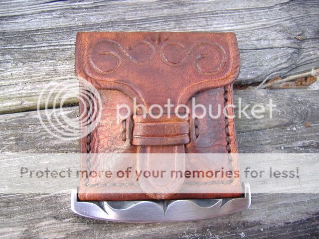

Here's what I am HTing. The steel is 1/4" x 3/8" at it's widest. I also make smaller versions which are 1/4" x 1/4". Water quench. The smaller, so far, have not cracked, but I am getting cracks on some of the larger. All the cracks run with the grain, and are very fine, and not easy to see. I get one or two on each, and they go for maybe 3/8" long to 1/2". They appear to be shallow cracks, but can't say for sure. This one in the photo has two, but they don't show in the photo.
Sorry, my computer went down. Thanks to all who replied.
Don, that is a colonial period pocket fire starting kit. There is a cotton cord and flint in the pouch, with the steel hanging below. It has to be high carbon and hard to spark well. The striker is 1095 1/4" thick, 3/8" wide, and 2 15/16" long. Unfortunately, these work best at full hard, or at least very close to full hard, as far as my experimenting has shown.

Well, I just completed the brine quench on one of these strikers using Patricks method. Came out great so far. No sign of cracking yet. I used a propane torch to temper back the side ears where the holding pin goes through. The brine was heated to 135°. I figure a few hours will tell. Have not heard the dreaded ping yet. I found the brine to be much less violent than plain water.
