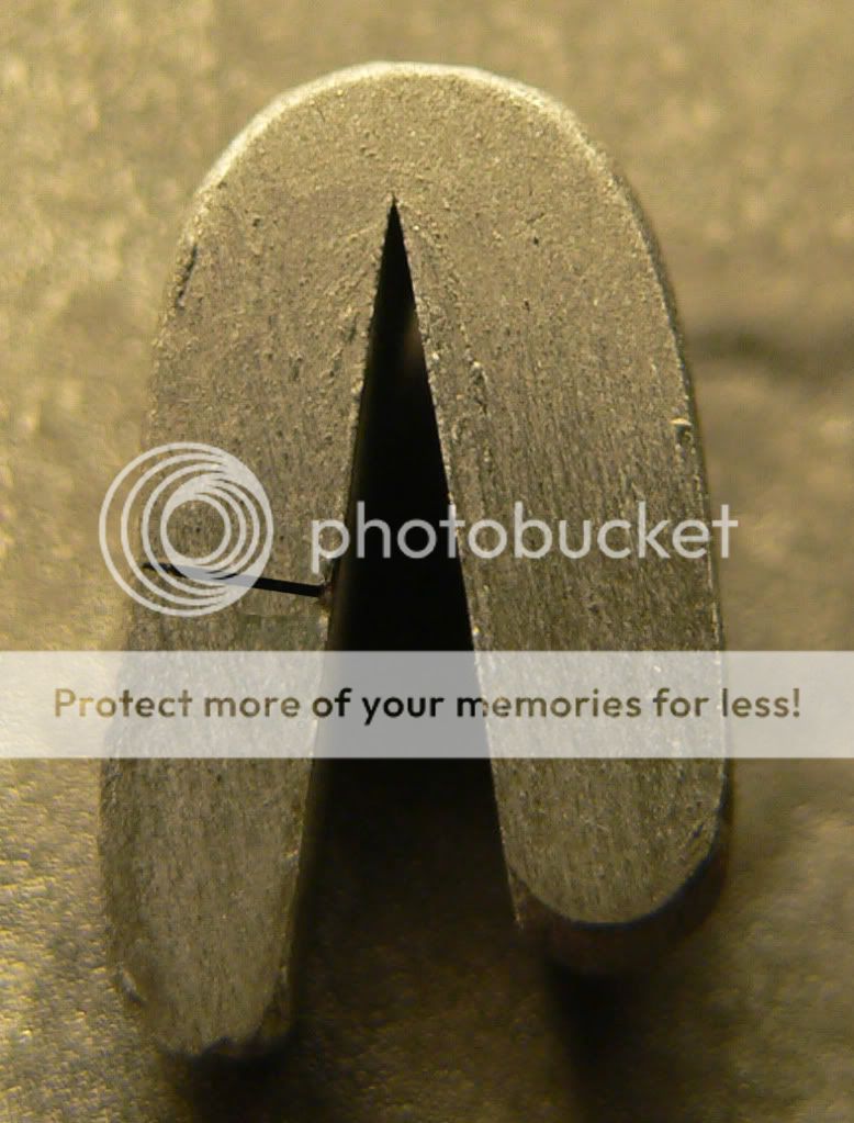

Had some free time to kill, decided to check why MY Bravo 1 was such a good cutter.
Measuring thickness and angle of convex grind is not an easy task. I've seen recommendations to use candle wax and some things like it, but I was having troubles getting accurate measurements with that.
I decided to use J-B Weld Stick. As many might know, it applies as a putty and hardens like metal (more like hard plastic). I spayed some WD-40 on the blade, so JB won't stick to it and put JB to work. I let putty harden for several minutes, then removed it from the blade. To get an accurate edge profile I used sandpaper (80-220-400 grit) to cut the top uneven part off. After this procedure I verified the profile by inserting the knife again. Perfect fit. I have marked 1/4" distance from the very edge and took a high-res picture with my camera.
Here is the picture:
Then I used photoshop to outline blade profile and calculated the angle and thickness results. Here is what I came up with:
Now, keep it mind that this is not a Brand NEW Bravo 1 straight from the shop. I have sharpened it in the past using sandpaper and mousepad (no powertools). I doubt that I removed too much metal, but still keep in mind that it is not 100% stock original.
Ok, we have some sound data here I think. Anyone care to interpret it and/pr put it into real world perspective some of us mathematical bleepards can easily follow?

The problem is that you can NOT apply the translation of those numbers to a stock Bravo 1, because mine is not new and been sharpened several times. I might have (most likely) thinned down the edge and lowered the edge angle in the process. I have no clue how much difference there might be from a stock knife.
Here is what I can say about MY B1:
I was always wondering what made My thick B1 to perform at such high level. Well, now looking at my pictures and measurements, it is easy to see that angle of the edge is quite low. First 1/4" of edge (and even further) looks almost like a scandi grind (or zero flat grind) with low angle, though there is definitely a slight convex curve there.
Low edge angle (21 inclusive in first 1/16") has it's advantages and disadvantages. Advantage is the cutting ability. Lower the angle, the easier edge goes through material. Disadvantage is edge toughness. Lower the angle, less steel supports the edge and edge chips and rolls easier, than at higher angles.
At .215" stock my Bravo 1 is a thick knife, but it outcuts many other thinner knives in tasks like making fuzz sticks, cutting thin rope, paracord and others. It outperforms other knives, if task does not require a deep cut, because there is very little drag added due to thickness and most of it is compensated by smooth convex grind. But cutting a tire for example (I have never done it), I imagine Bravo 1 will be a pretty bad performer due to the spine thickness.
B1 cuts fresh meat fine, but cutting fruits and vegetables is not good (feels more like chopping).
21 degree edge is great for cutting, but not good for abuse. I haven't had any problems with the edge yet, but I definitely will think twice now before doing anything stupid with it.
What's the advantage of the thick spine, if edge is so thin? The only advantage I see is in batoning and overall blade toughness. Haven't pried anything with my b1 yet, but I did some batoning. Edge holds up pretty good and thick spine helps split the wood. Other than that, thinner blade sure is better for cutting or slicing.
For playing in the woods (mostly fire prep) I like my B1 a lot. I choose a knife with thinner spine for the kitchen.

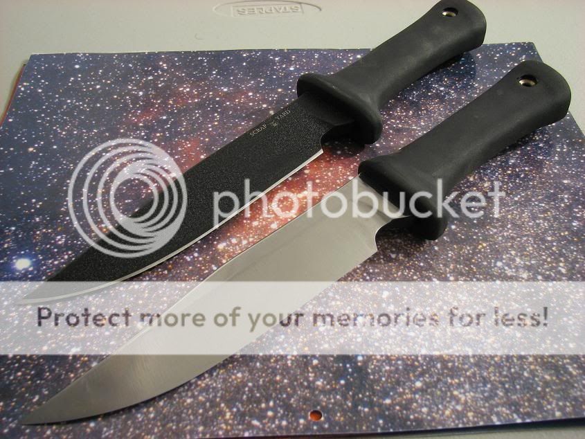

Here is a picture of the same Bravo 1 edge profile cast on top of Ka-Bar Short (5 1/4") USMC knife. Not the best picture, but you can see the difference there.
That might explain why some Bravo 1's have a tendency to roll during batoning. I wonder if a balance can be found between a thick bladed bushcraft knife thinner bladed slicing knife.
