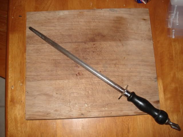

alright, I decided to let the patina/tarnish/whatever you want to call it stay, if it gets to be too much I'll take some brasso to it, I don't know if any of you have seen this knife yet so here she is, she's a wicked slicer!!
spine shot
edge shot
thanks
looks like your questions have been answered, so i just wanted to say that is a fine looking blade, very old-timey looking, and i think that patina only makes it look better.
I'd have to agree, and it looks old timey because it is actually a restored blade from the early 1900s that spade is the original forgers mark, and did I mention that this thing slices???
