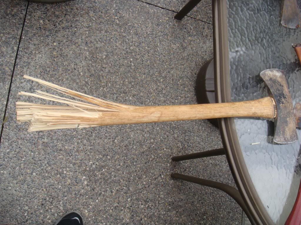

Broken handles on Axes, hammers all striking tools. Post what you have, what you can find. Preference for pictures where you can make out the fine detail.
Stories, experience with broken handles how they happened.
Pictures of broken handles purchased to get the head.
Go for it.
This thread got me thinking of the surviving vintage axes that I have. To be honest it is much more skewed than I remember regarding grain orientation. Besides some axes that have led a privileged and pampered life I have only one axe that has survived hard use with the grain running contrary to conventional wisdom. Its a pulaski with a straight haft.
