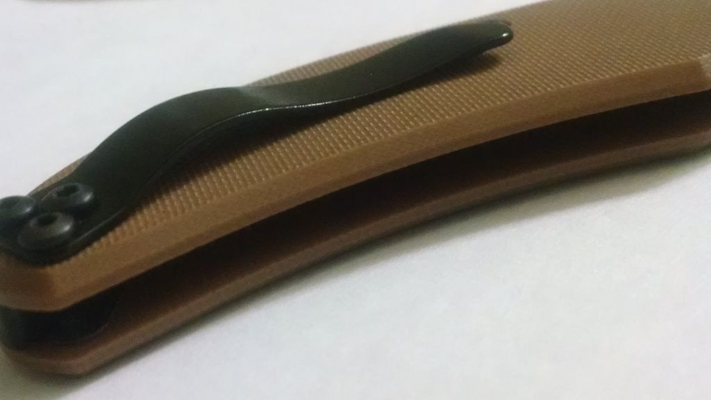

First wrong...pocket clip. Awful and makes one handed put in pocket and removal about impossible. Come on cold steel. It's a major fail. Im going to have to bend it myself and its gonna need major work.

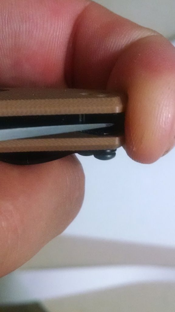

Second wrong....i can catch my finger on the tip of the blade when folded. Its very minor, but still.

That's disappointing. Especially the second "wrong." If the clip is too tight that can usually be fixed by bending it.
Yeah...it has no real room for pocket material, due to its shape. Its typical cold steel. They do so much right but have the wrong person or people designing ocket clips for them.
I love the knife but I agree about the pocket clip. I will have to loosen mine up. I like everything else about it.
I never carry any Cold Steel clipped. A big reason why I bought a Broken Skull. I can just carry this one down in my pocket un clipped. It's light and thin, yet big enough to easily find in the pocket. I'll keep the clip on it as a leverage point for my pinky when opening the knife; my little finger hooks the very end of the clip when thumbing it open.
I can also feel the tip when closed, if I press my finger lightly against the end of the handle. But I don't see that as a big issue with this knife. It's because it's a clip point that's as long as it can be for the handle.

The exposed tip isn't necessarily a hard fix-taking a little off the kicker should drop it into the handle further

Jw Bensinger, yes Sir. Its not bad enough to fix it now, but over time from sharpening and reprofiling it will have to be addressed as you mentioned.
The pocket is super tight.
Adjustment was easy. Just use a "gutted" piece of paracord. Slip it under the clip and pull judicially to reduce the tension.
Works great.
My finger doesn't touch the tip unless I'm really wedging and pinching it in there.
If your not purposefully attempting to feel the tip your fine , no safety issues.

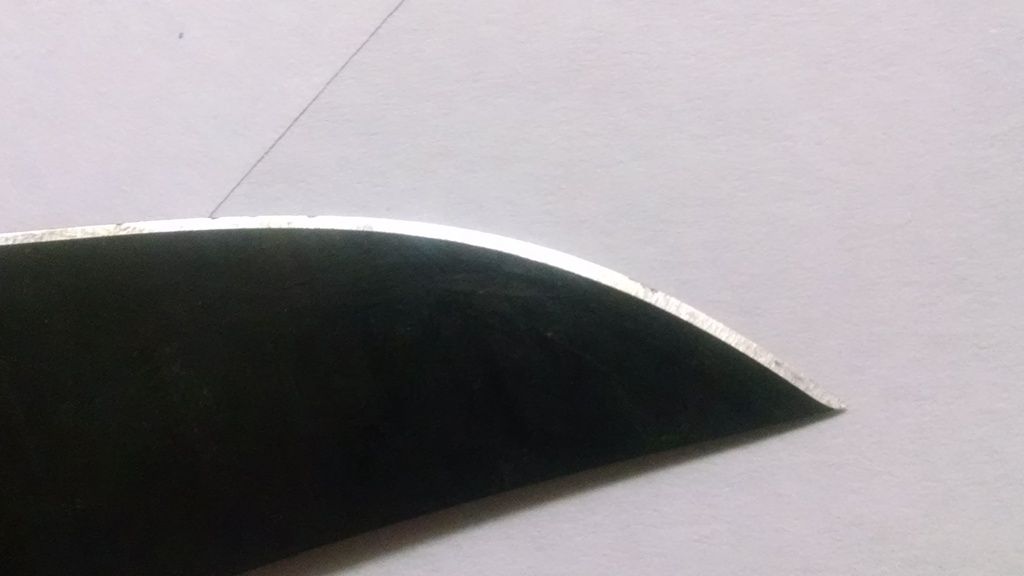

It has a decent factory edge. It stroped up great, very response.
The edge took damage from chopping tree branches and hacking briar patches.
I stroped the edge on a fine diamond stone a few passes and a then one white ceramic.
Bam!
Screaming sharp.
Doesn't have the edge holding of S30v but is a breeze to sharpen and takes a great edge. It very much pays homage to AUS 8a in that regard. Great steel.
^ great pics! I do agree that the pocket clip is too tight, but i never think the tip is an issue at all. It take a very deliberate effort to get cut by the tip when the blade is closed.
