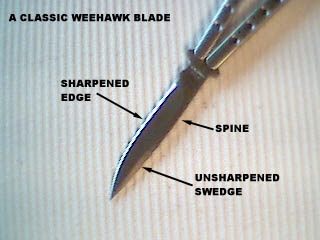

actually had a gentleman inquire if I could sharpen the back edge of a balisong, am I missing something here? I enjoy working mine and I don't know the technique that would allow me to continue enjoying it with double edging.
Gollnick, whats a swedge? and thinking W? sorry if this is a little elemetry, but as you can see by my post count...
The proper term for an unsharpened suggestion of an edge on the spine of a blade is "swedge." A "false edge" is a sharpened edge on the spine of a blade that does not run the full length of the blade. A "double edge" obviously has a fully sharpened edge on the spine. A skilled balisong artist can manipulate a double-edged balisong. Even a less-skilled artist can manipulate one with a false edge with just a little extra care.
Often, balisongs and other knives are sold with a swedge instead of a false edge because of legal restrictions on "double-edged" blades. A swedge helps the knife penetrate when stabbed. It just "stream lines" it a bit so that there's less resistance. Converting a swedge to a false edge is then left to the owner as an exercise. While it can be done adequately with most any sharpening stone, rig, etc., it's often a lot of work since there's a lot of material to be removed and, for the unskilled sharpener, the results are often not as even and attractive as one might like. So, that task is often brought to a professional with adequate equipment. Someone like you.
