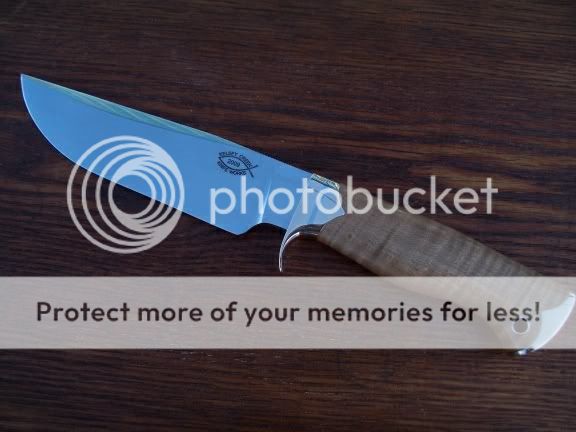

Dave, Don made this hunter for me this year using bronze for the guard and pin.
Not sure the type of bronze but I'll ask him and get back to you.
Should have done that before I posted. :o :)
Doug

Beautiful hunter Doug/Don. I really like the patina some bronze gets.

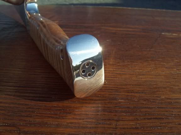

What got me thinking about it was the guard (silicon bronze) on a bowie I received from Jason Knight & Jimmy Chin a little while ago. Still getting around to taking some pics.

The link to Atlas that Farmer Phil posted is where I get mine from too. I like to use 655 Silicon Bronze , no, wait........... I love to use 655 :thumbup: :thumbup: I get it in 1" x 1" x 36" L. bars
Here's a Take-Down I made using 655 for a majority of the fittings. There's a slice of 416 S.S. in there too ;)
