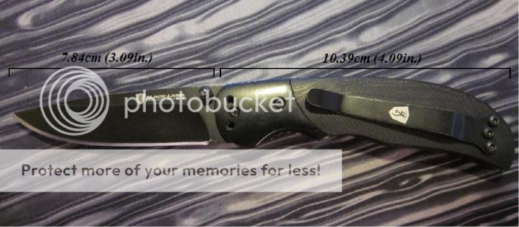

Black Label knives only came out within the past year (sometime around September of '11) and some of these knives from Browning are worth checking out. The Submission 320120BL is one of them. It is an imported locking liner folder that features a 7.84 centimeter (3.1") drop-point blade and a four-position pocket clip as well as all-black hardware.
Starting from the front:

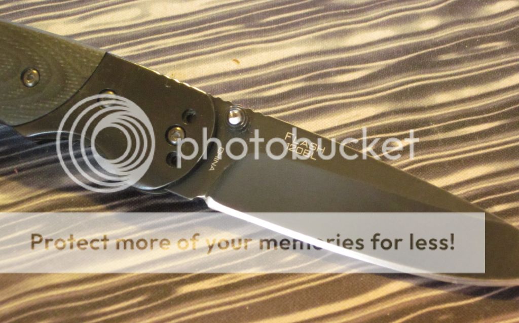

The blade is drop-point style (Browning tells us it's spear point) and is hollow ground.
It is a 2.7mm-thick (1/10in.), 440A stainless steel blade and I must say that I am quite impressed with the weight of this knife despite its chunkiness.
The whole thing weighs 107 grams (around 3.8 ounces) so it is by no means a lightweight, but it is not unreasonable.

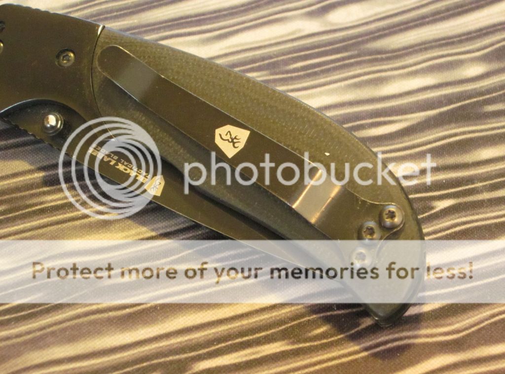

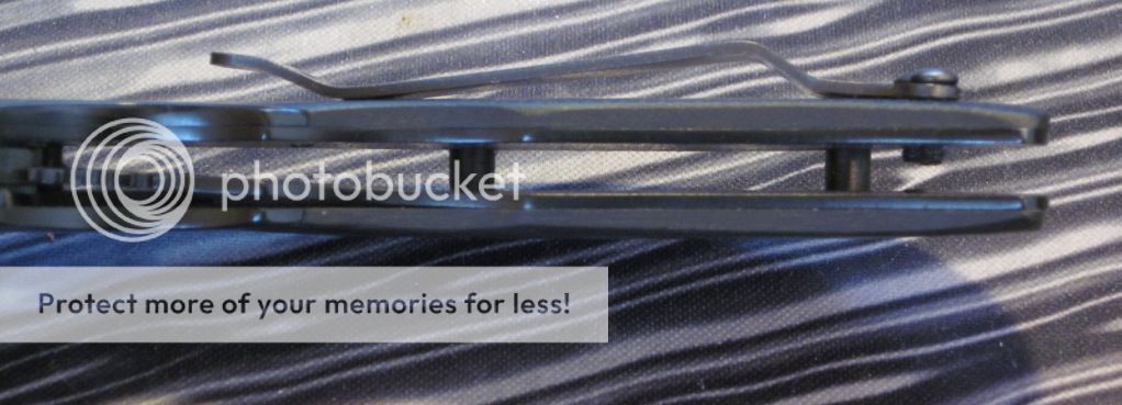

This brings us to the pocket clip. As mentioned above, the screws on the Submission will not last long if loosened/tightened often and they stripped out on me after removing the pocket clip once.
You may notice on the pictures that the pocket clip requires three screws for proper mounting and there are only two empty holes on each end to accommodate it. I'm not sure what the designer was thinking, but the lengths of the pocket clip screws and the screws that retain the handle scales are not the same and so you must unscrew whichever screw is in the place that you plan on putting the pocket clip and replace it with the longer pocket clip screw. This switching around of screws really messes up the threads on these soft screws.
I remedied this whole issue for my own knife by taking the three screws from the spare pocket clip of my Cold Steel Mini AK-47, which luckily fit just right (they do stick out a tiny bit inside the handle, but they clear the knife when it is folded so it isn't a problem).
If you are a right-handed person, I recommend leaving the pocket clip the way it comes.
