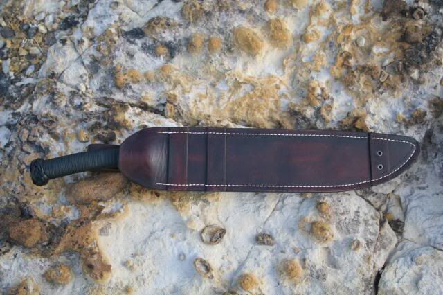

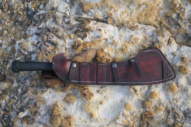

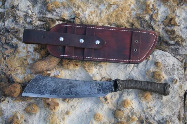

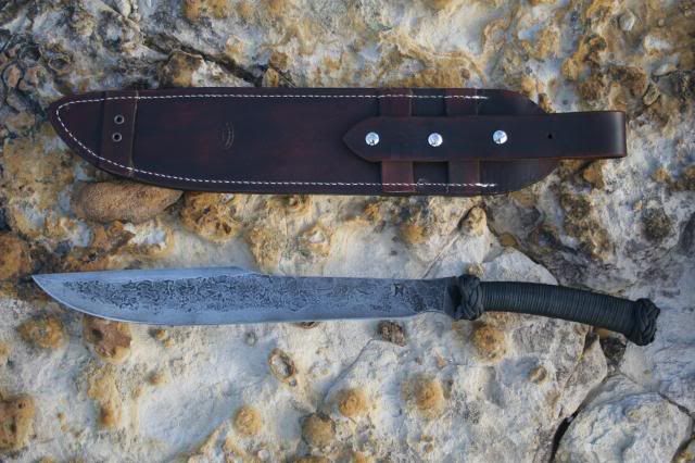

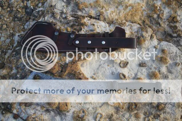

Finished these three recently and got them in the mail. All three are 5160, triple normalized, triple hardened, and triple tempered. The sheaths are all built by Luke Swenson. All three sheaths are built to be ambidextrous (which, as a lefty, I really like), with adjustable height belt loops, and leg tie-down areas.
Short bush sword:
I forgot to take measurements before packing away, but this is approximately a 14" blade. The raised clip is a false edge. Handle wrap is black paracord impregnated with epoxy, with two-strand Turk's head knots fore and aft.
Bush cleaver: About the same length, but a bit heavier. Also in black paracord with two-strand Turk's head knots.
Mini-parang: Posted this before without the leather. Blade is 10 1/4". Hemp cord with epoxy on this one, with three-strand Turk's head knots.

those are some awesome tools , your proportions are great and it looks like a really well thought out package. The sheaths just put it over the top. Nice stuff:)
I like the bush cleaver a lot. It reminds me of the lambsplitter I had before the fire.
