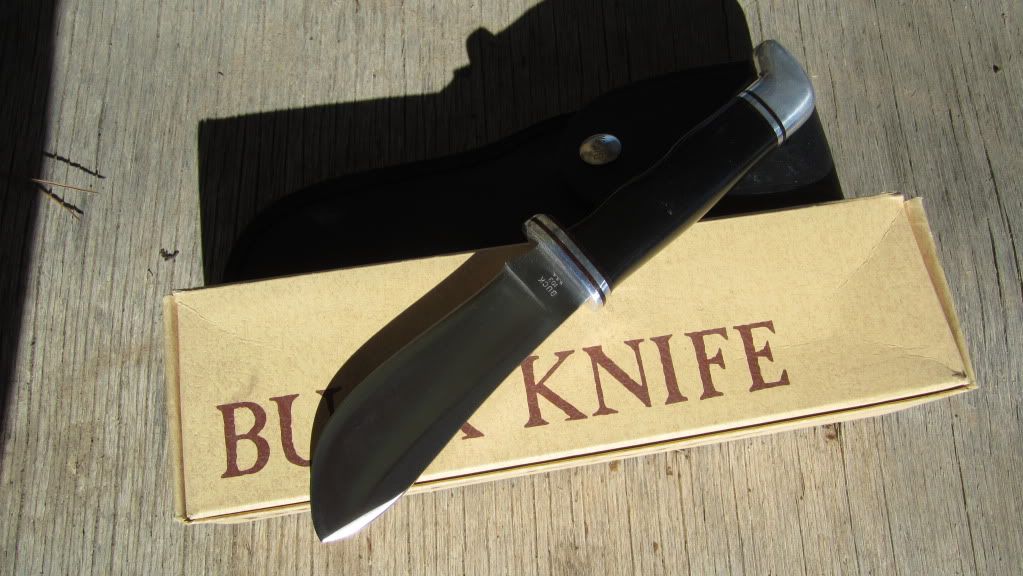

I was just gifted one of these knives, and I don't know much about it. I searched here and youtubed it but there is surprisingly little information showing this knife in action.
I come from a bushcraft background where I abuse my cheapo Mora's , not a collector. To be honest I've never actually owned a BUCK. Are these users or just something pretty to look at? I really like the shape, I'm sure it would make a great skinner - but I don't do very much of that.
Thanks folks, glad to finally own a BUCK.
