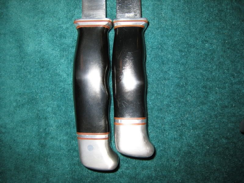

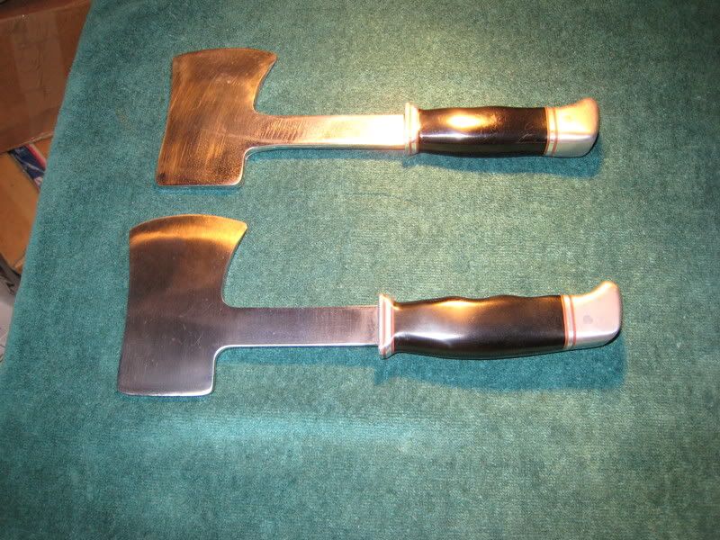

Here are a couple of Phenolic 106s. You might note the difference in the length. The Shorter one is a Buck* and the larger one is a BUCK USA both around 1967. Not perfect but then I have a few dents and scratches myself.
Enjoy,
Telechronos

The info exists, TAH, and I can give you a run-down when I am more sober ;) If I ever learn to operate that digital camera around here somewhere, I'll take a picture of the other dozen, besides the BUCK*, that made-up the line of 106s from '65 to '02 or thereabouts... if I sober that is. Robert brought up a good point in the fact that two phenolic lengths exist. The longer phenolic handle is the newer of the two. However, longer phenolic 106s were prone to cracking to a degree as were the phenolic 124s. Not common to them but certainly experienced by a few examples of each.
