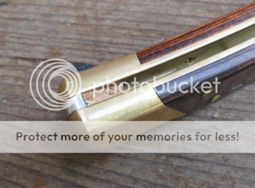

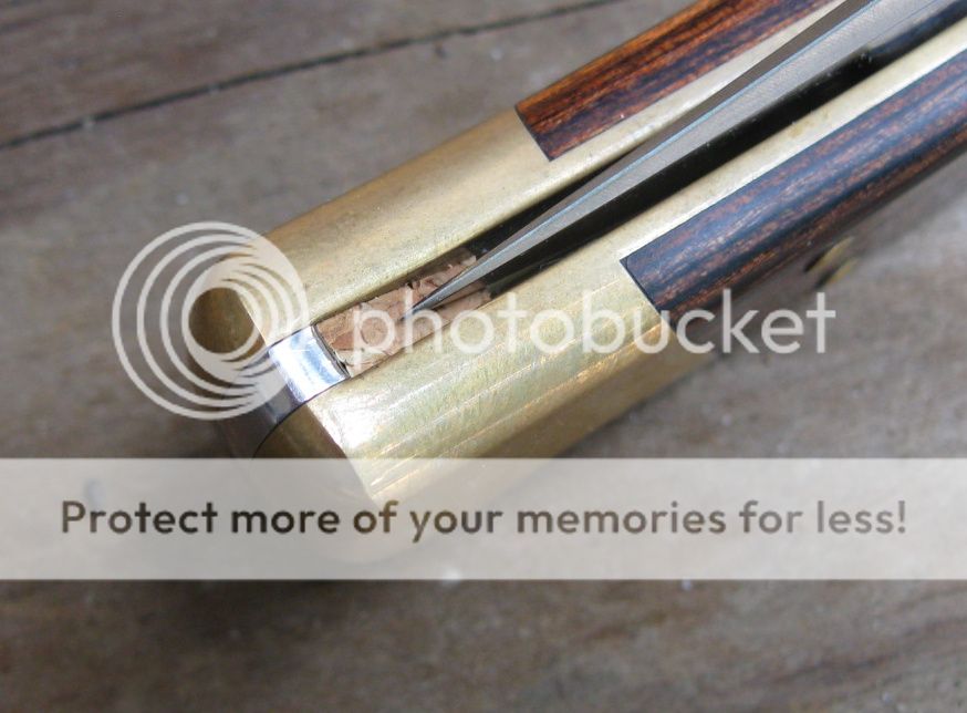

If the blade's hitting the backspacer even when you close it gently, I'd send it back to Buck for repair. If it's only making contact if you let it snap closed, or push it closed, you could try cutting out a piece of cork and wedging it between the liners to cover the spacer. Some people do that with Laguioles and similar knives. I used that trick on my 110 a couple of years ago and it's been working well so far.
