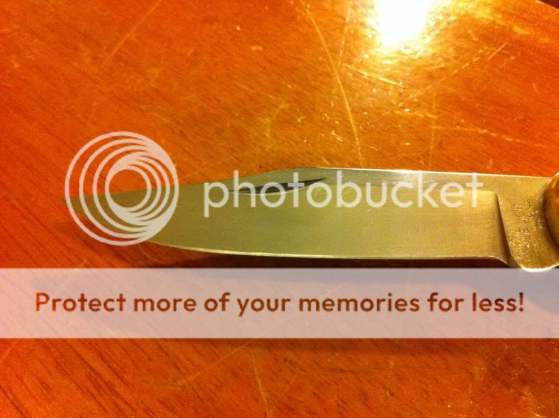

a co-worker asked me the other day if i could "do anything" to fix his 110. here are the before and after pics, i think he'll be happy tomorrow ;).
what the knife originally looked like:

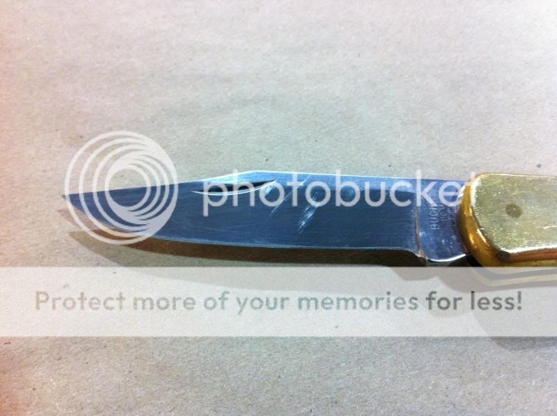

after i reshaped the blade

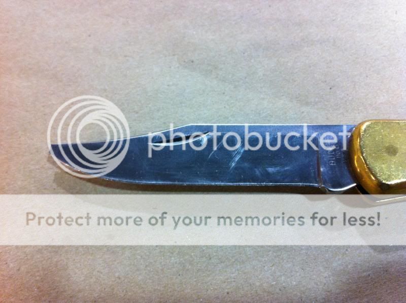

finished after polishing and sharpening
Nice. Did it thicken the blade out too much removing that much metal?
any extra thickness at the tip is not really noticeable (unless you put a new 110 next to this one). i re-beveled the spine in the curve all the way to the tip.

Honestly though, you did an outstanding job, most reshapes end up looking awful, this nicely keeps the shape of the clip point.
