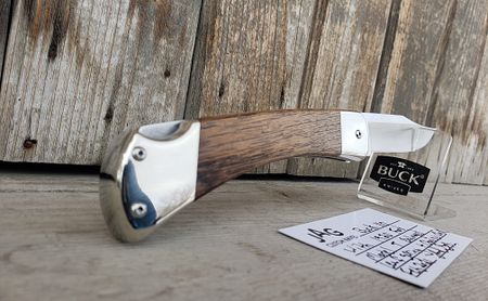

Last summer we were out on the ATV in the middle of nowhere when we found a old road that had 50 year old trees or older growing in the middle of it. We decided to walk it. As I mumbled I wouldn't be surprised if Model Ts drove it once. A few minutes in I saw a piece of rubber on the forest floor that looked like a dirtbike tire at first. I said to my girlfriend...hmmm maybe this is a model T tire piece. She giggled and said look over there.
Well what do you know! There was a Ford Model T chassis and drivetrain hidden in the woodwork ahead. It looked like it had been there for several decades.
We decided there was some good junk there worth retrieving, so my strong friend and I went back the next day with an ATV, a cordless zip disc and a utility trailer to grab whatever we could fit.
This included the leaf springs, the engine/trans , a couple of wooden spoked wheels, and even a nice chunck of Oak in one of the corners of the chassis ( factory frame reinforcement )
Upon disassembly of the leaf spring packs, wanting to forge knives from them, I noticed an embossing on them: " Ford " pretty cool. There was plans then to save the logo on a project, but I was not yet sure it's design.
I first had to straighten and anneal the spring in my forge without damaging the embossing. Then the edges were CNC squared, and faced to thickness. I designed an oversize scale program and used a test piece of Lexan to superimpose the script in the ideal location for a 110 scale.
The reverse side was made with the ( milled 100 years ago! ) piece of oak recovered from the chassis.
I have enough to make one or two more, and think an Aurum etch Ford Blade would to it off if I can find one. ( hint, hint )
Thanks for watching!
Transverse Leaf spring
Straightened ( somehow to within .025") and sawn
Edges faced for clamping
Facing program
At Thickness
Test piece
Rough shape program. I left it a bit big to give room to hand fit
Shown with The Chassis Oak
