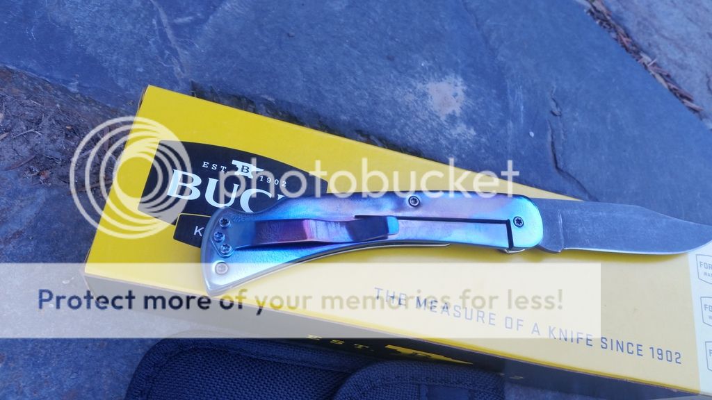

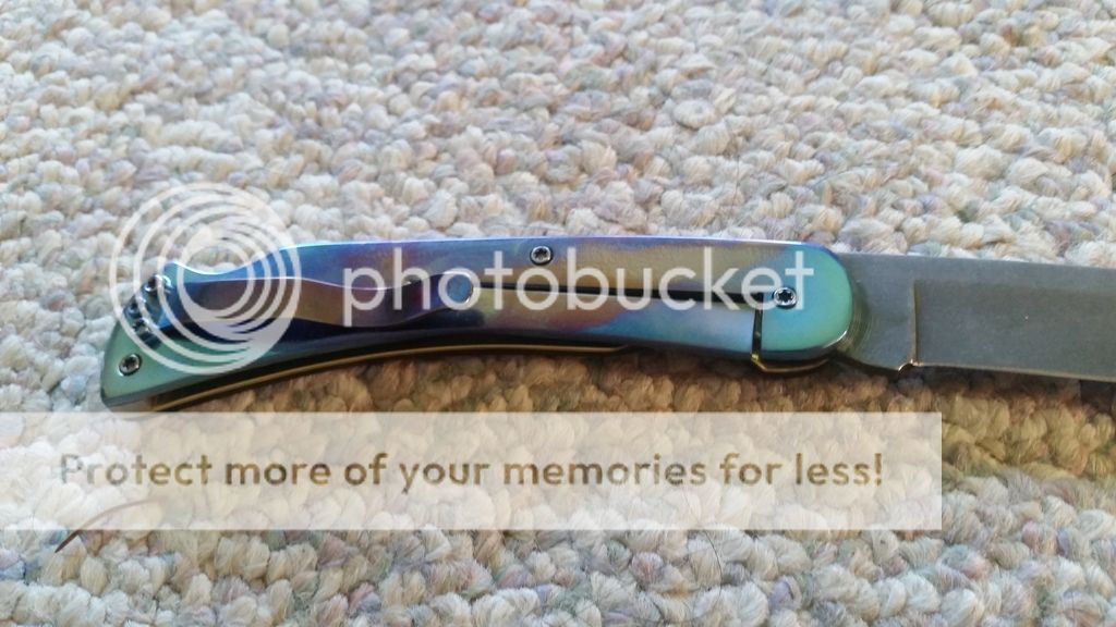

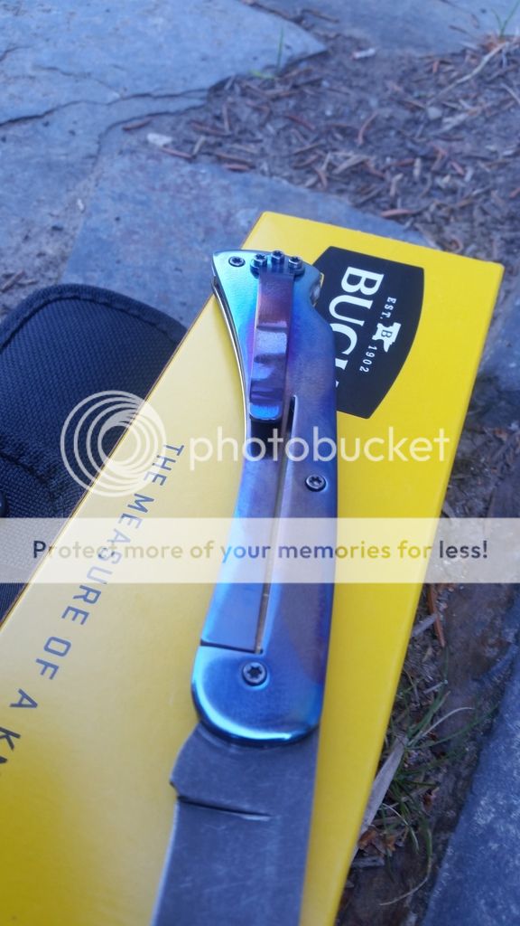

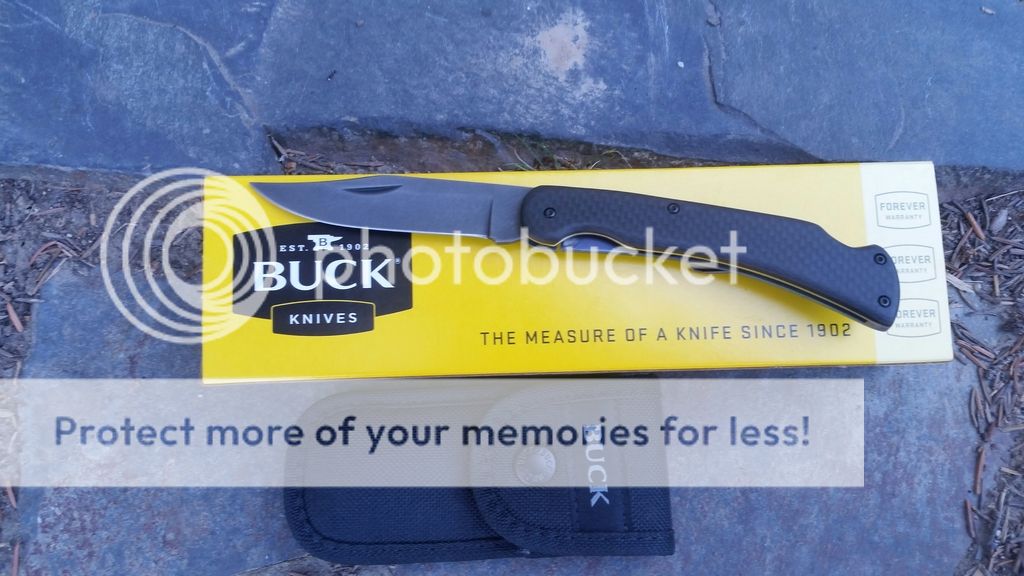

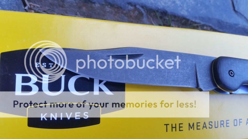

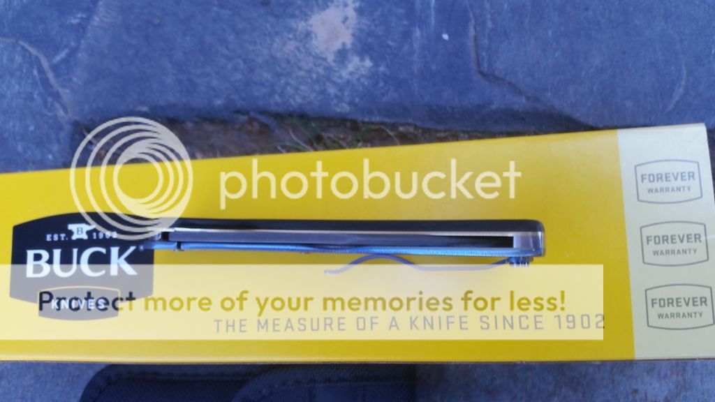

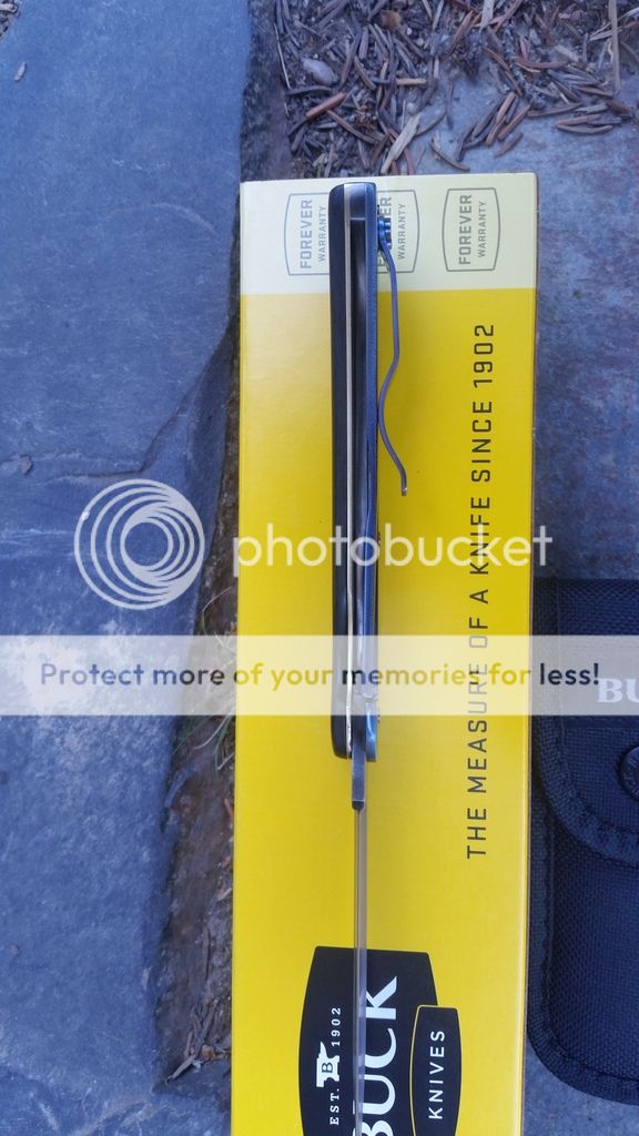

Here is a Buck 110 S30v blade that has been acid etched/stonewashed and put into a Custom Frame by JAG. Rainbow anodized titanium frame with titanium screws and pocket clip. The lock bar has been carbideized and the blade has bronze bushings on either side. Good action, lockup and centering. High weave carbon fiber scale on the opposing side and black oxide screws on top of a .040" brass liner give it some warmth. Blade stop/spacer is spring tempered 43-45 RC 440c stainless.
The picture best shows the way the titanium looks
This is about 40 hours of work to completion. Contact me for sellers info
