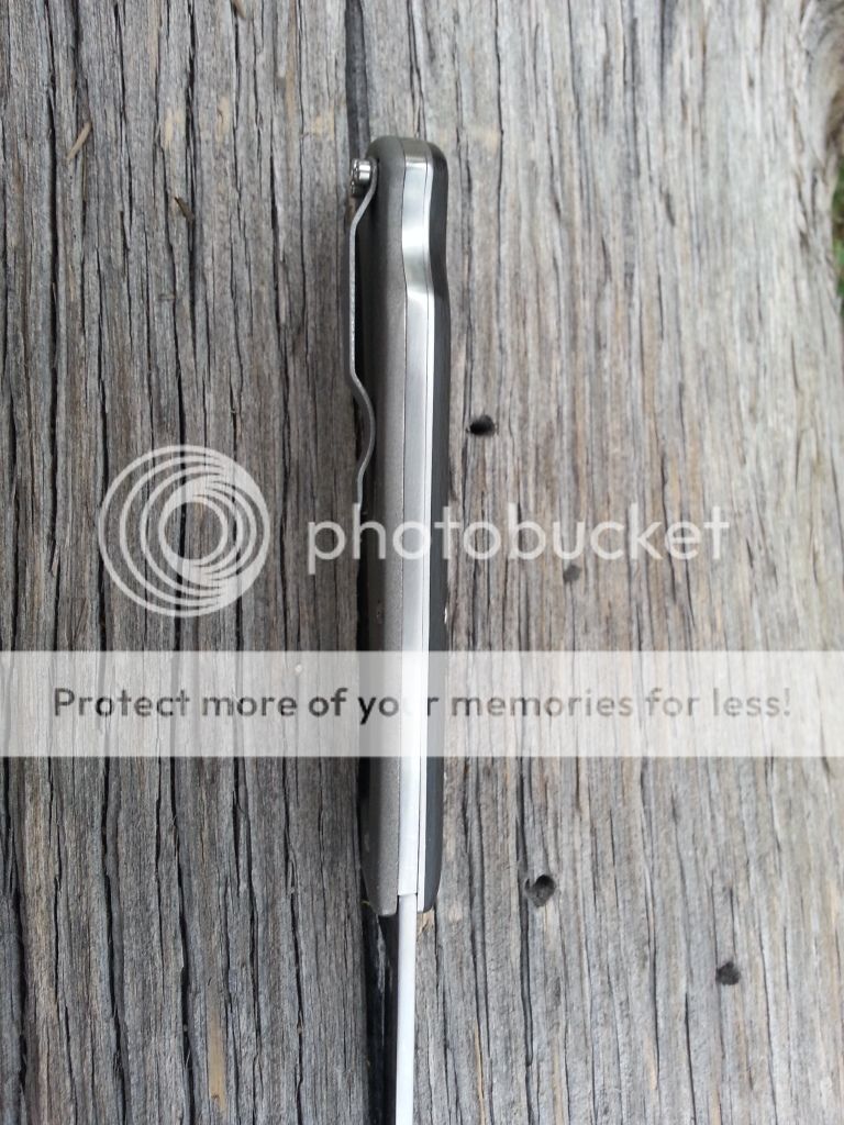

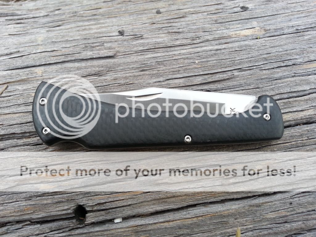

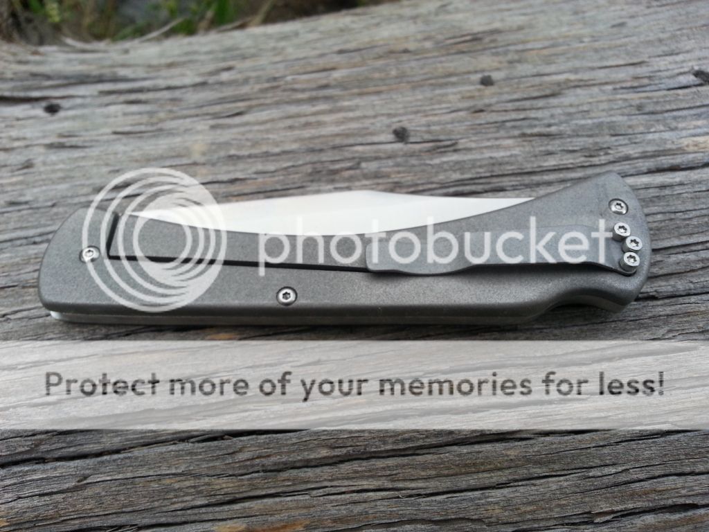

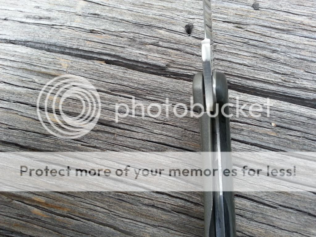

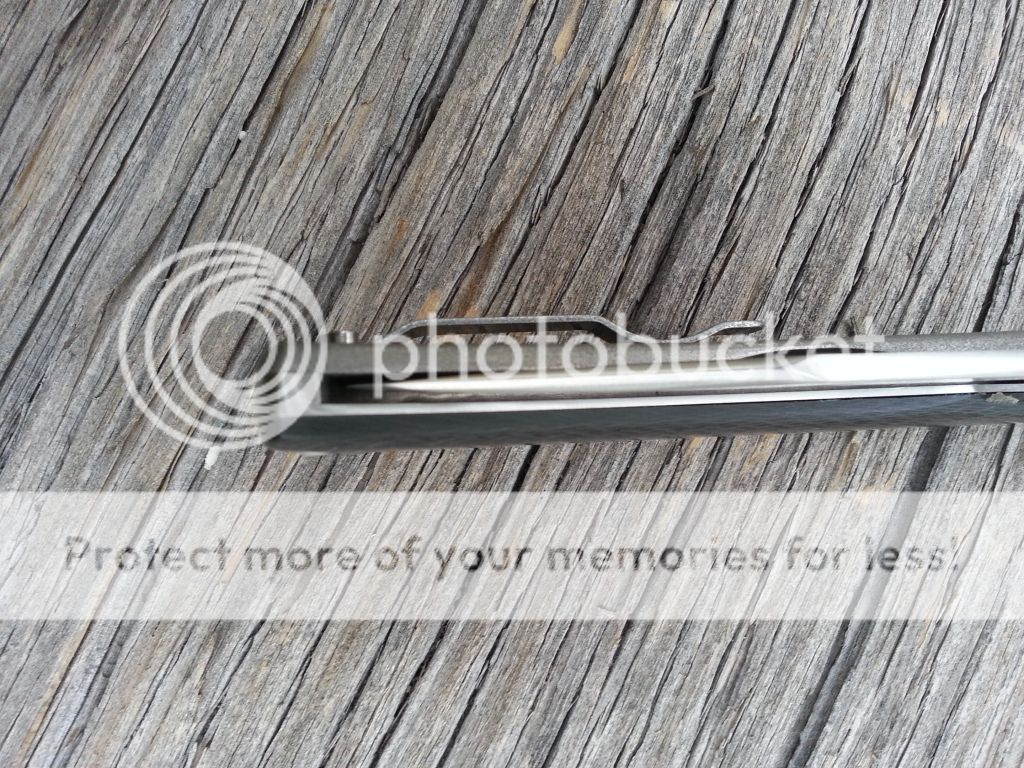

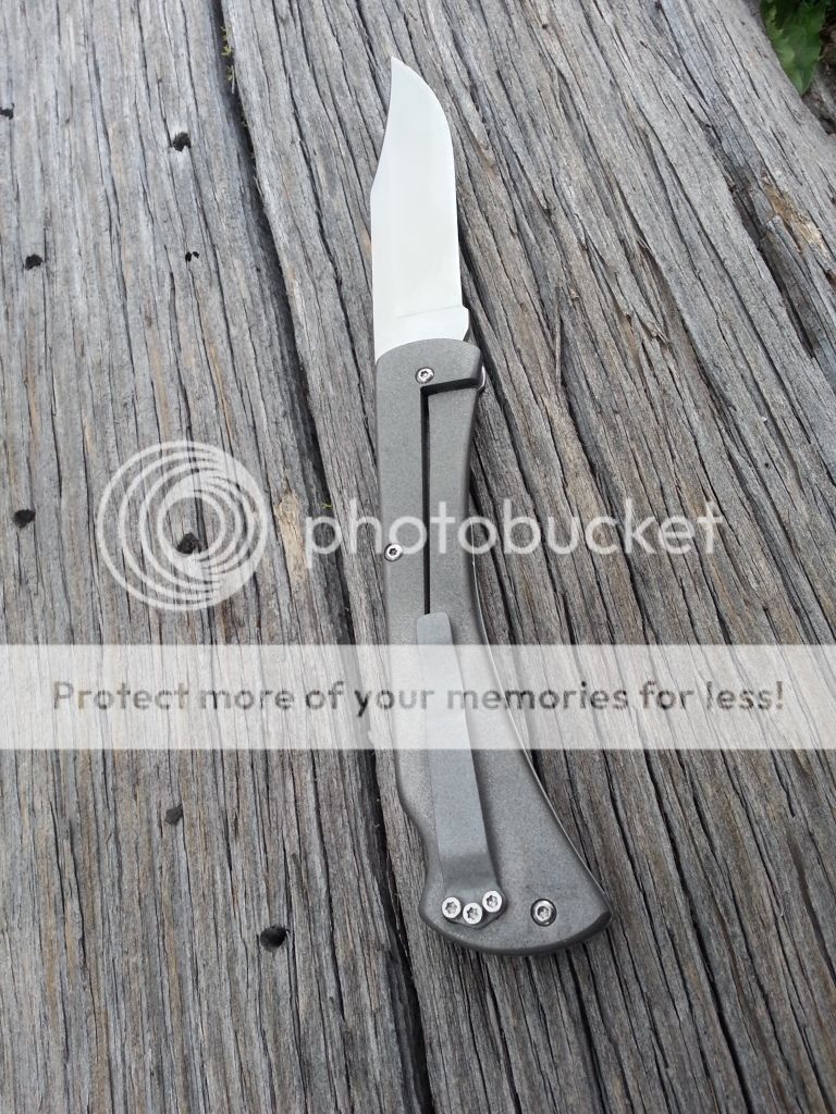

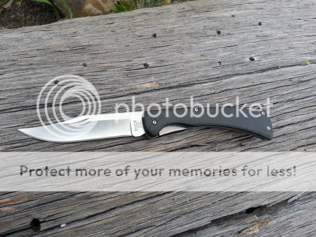

Here is a 110 with a titanium framelock conversion. It features 0.125" 6AL-4V Sandblasted Titanium Frame and Stainless clip, which is mounted a alongside a stainless liner and carbon fiber scale. Spacer/blade stop is a spring tempered 440-C Custom Piece. There are bronze bushings on each side of the blade, and a stainless friction reducing ball, which also acts as a detent. The action is smooth and lockup is solid. The lockbar has been carbidized. Blade centering is 45/55 The pivots and hardware are stainless as well. light weight @4.2 oz.
SOLD
Wow, I know this is old but I'm just seeing this. That's got to be THE coolest buck 110 I've ever seen.
