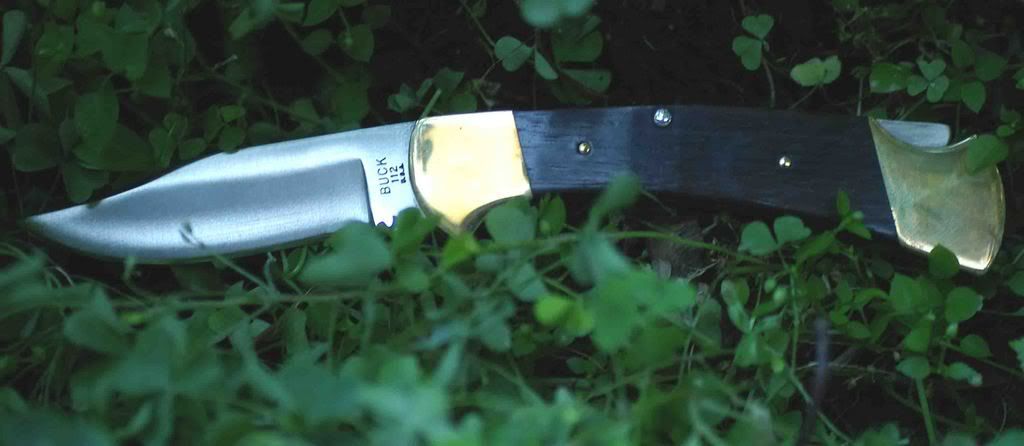

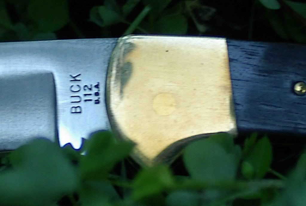

Hi Guys,
This knife I found on eBay last week. It seems to be an early Version of the Ranger. Does anybody nows what kind of wood the scales are?
Many thanks for your answers.
Best,
Haebbie
Not that my opinion means anything after Larry says something :D but I would agree that it looks like ebony.
is the ebony rare on a 112 ?
i have to remind my self that i only collect 110's so this is a knolage queston only ...
yea this is for more knolage only!!!
Dave, it is well known, that you mean that you only collect 110s. But your knowlege at other Bucks is mostly a lot better than others who collect not only 110s - like me.
But to your question:
The material of the scales makes the difference between the second, third or fourth version of the 112. And if they are made of ebony the knife is from the fourth Version, that's all. I don't know, witch one is made oftener than the other. Does anybody knows it?

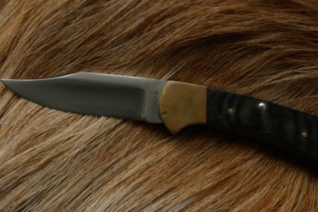

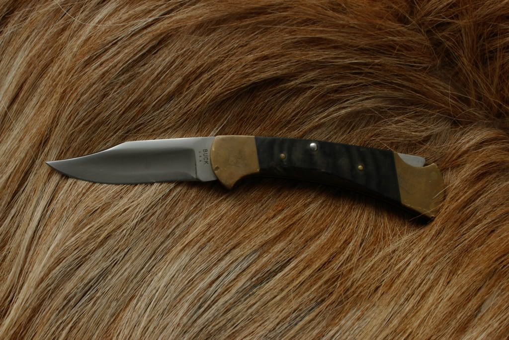

Haebbie, I thought I'd share some photos of an original 3rd version 112 Segua and and a re-bladed Segua handled 112 and a 432 that's not initialed. The 432 handle material was not Segua, I believe Joe said it is stained Birch.
Thanks again to hkingdom!
Thanks a lot, Scott, for your information and the pic's. It shows me, that the Segua has another structure than the Ebony.
When I compare the photos the scales of the 112 locks like Ebony, already therefore, your knives loock somewhat different.
Haebbie
