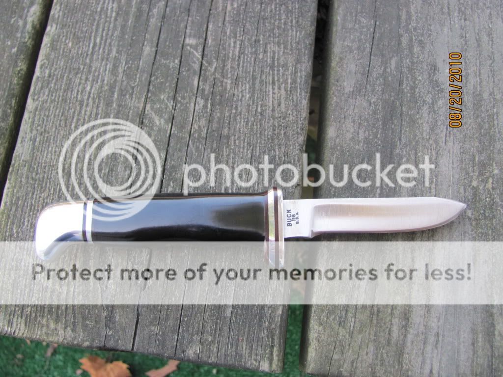

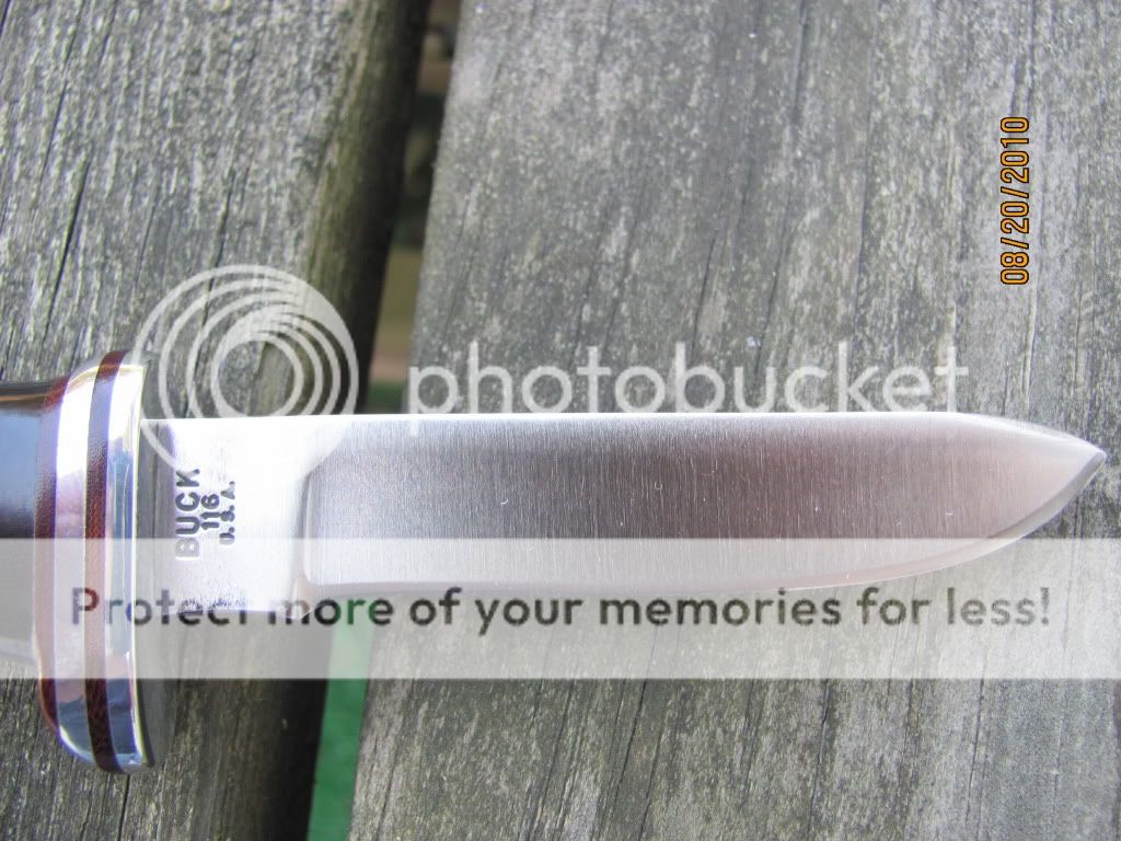

Hey guys,
Getting back to the 1st thread that I ever posted, conerning the age of the 116. I was just looking at the tang of this 116, which just came back from the spa and noticed it has a 3 line inverted tang stamp. I was reading the BCCI newsletter May 2007 with a 116 article by Larry Oden. I have been thinking this 116 was later stock and near discontinuation time period but by Larrys notes:
Tang Stamps
As with the other Buck models, a second line of “U.S.A.” was added just below the
“BUCK” tang stamp on model 116s about 1967. It is believed that this was done to
facilitate the export of Buck knives into Canada. Sometime in late 1971 or 1972, Buck
added the model number to the tang stamp and this was also done across the entire lineup.
For a very short period of time, this three-line stamping was oriented to be read
with the knife pointed down, just like the earlier one and two-line stamps
this appears to be a pretty rare '71-72 vintage 116, would you fixed bladers out there concur?
I have one inverted 3-liner Fritz. I believe its my 120.
I think you made a real find. Buck didn't to those tip-down 3 line stamps but a short period of time.
Did it come in that condition from the flea market?
I have three fixed blades read with the tip down, a 105, a 103, and a 118. They are sweet when you find them. HL
Ima, Those inverted three liners are 1971 . That model was discontinued much later as I had my daughter check and in her collection she has a 1989 . I'll have to do further checking as to a more accurate date of its discontinuance . DM

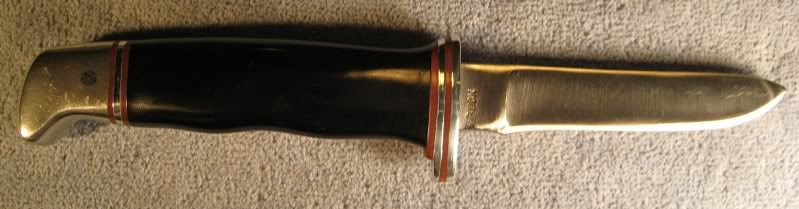

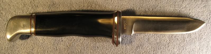

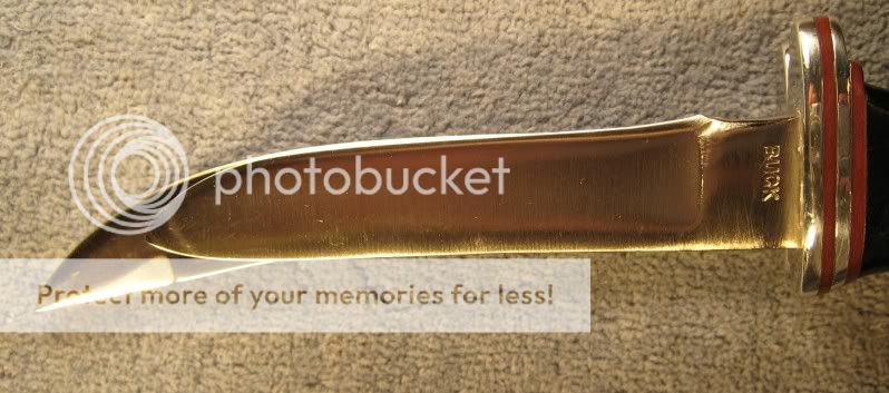

I posted this in the SPS but it probably is more appropriate here.
Here is a pair of early 116s. One a BUCK 116 (1963-1966) and the other a BUCK* 116 (1967).
It is interesting to note that even between the two knives there are significant changes.
Note that the earlier BUCK does not have a bevel at the top of the tip whereas the BUCK* and all later 116s have that bevel.
Secondly, the earlier BUCK blade is .083 in thickness and the BUCK* is much beefier, micing in at .116.
Note also, that the blade grind is different.
I do not have the fabled barrel nut 116.
IMAFRITZ pointed out that the very early 116s were probably reground 118s.
I have laid a BUCK 116 on top of a BUCK 118 and you can see that the 118 can be ground down to the size and shape of the 116. There is one difference which I did not photograph and that is the fact that the guard on the 116 is both wider and longer than the 118. If it were the other way, it would make sense. I can rationalize it by saying that, since those early knives were essentially hand made, the difference can be explained by a simple variation in grinding.
