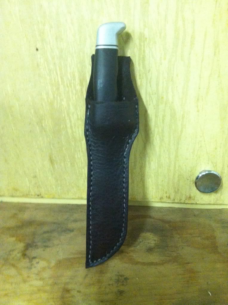

Thank you. Yeah I made the sheath from an old tool belt. The leather is 1/4 inch thick. I had to soak it in water and stretch the crap out of it for the knife to fit. Also, if you noticed, it's a lefty sheath. I'm a lefty so whenever over a fixed blade I either have to wear the knife backwards or make a new sheath. It was real tight at first but it's just right now

Wow i didnt even notice it was a lefty sheath, and made out of a belt.. Thats awesome! So far i havent had many issues with the knife being slippery... Honestly it doesnt feel any less secure in hand than the bhk bushcrafter i had. The handles more grippy than it looks. Idk how much stabbing/thrusting ill be doing with the knife truthfully. Its main use with probably be a hunting/general camping food prep knife, I will definitly keep that in mind though, I hadnt thought about that.

Now for the sheaths. For the "119->" I have, I HAAAAAATE the sheath design. I like the old flap over the top style or a velcro strap or a snap in the center type strap. The snap on the side makes it very hard for me to get to due to arthritis, neuropathy and such in my hands unless I can wear the knife sideways "under my gut :friendly_wink:" with the snap on the bottom for the right hand. Then the "103>" has a large slit in the back of the sheath from the previous owner. Any advice on fixing the leather? Can I get replacement old style sheathes from anywhere? Bighaze51, are you in the midst of making a 119 right hand sheath out of the rest of the tool belt that is as nice as yours that you'd part with? Hint, hint. I've only got some scrap purse leather. Even if it matched my boots a big leather sack for a sheath would get me laughed at by my friends. Only in a good way though. :eek:

Unfortunately, I used most of the belt to make this sheath so there isn't enough left to make another. I feel your pain though. I don't really like the sheath design either. I've got an old ww2 case knife sitting in it now.
You could remove the snap parts and sew on some strong velcro instead.
It should be easy to drill out the snaps to remove them.

Bighaze51, If I start making sheathes, sir you will be imitated. I like that work.
After poking around eBay, Amazon and a few vendor sites, I think DesertChris' suggestion to drill out the snaps and go with velcro is what I'll do. I might even get a small fishing plug body fastened with a leather shoelace or something similar to grasp to pull it open.
