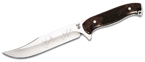

For review: Here is an 819. As you can see, it is not a 119.
