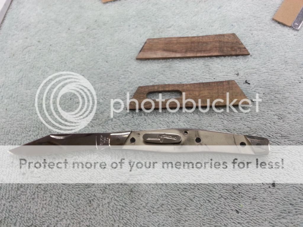

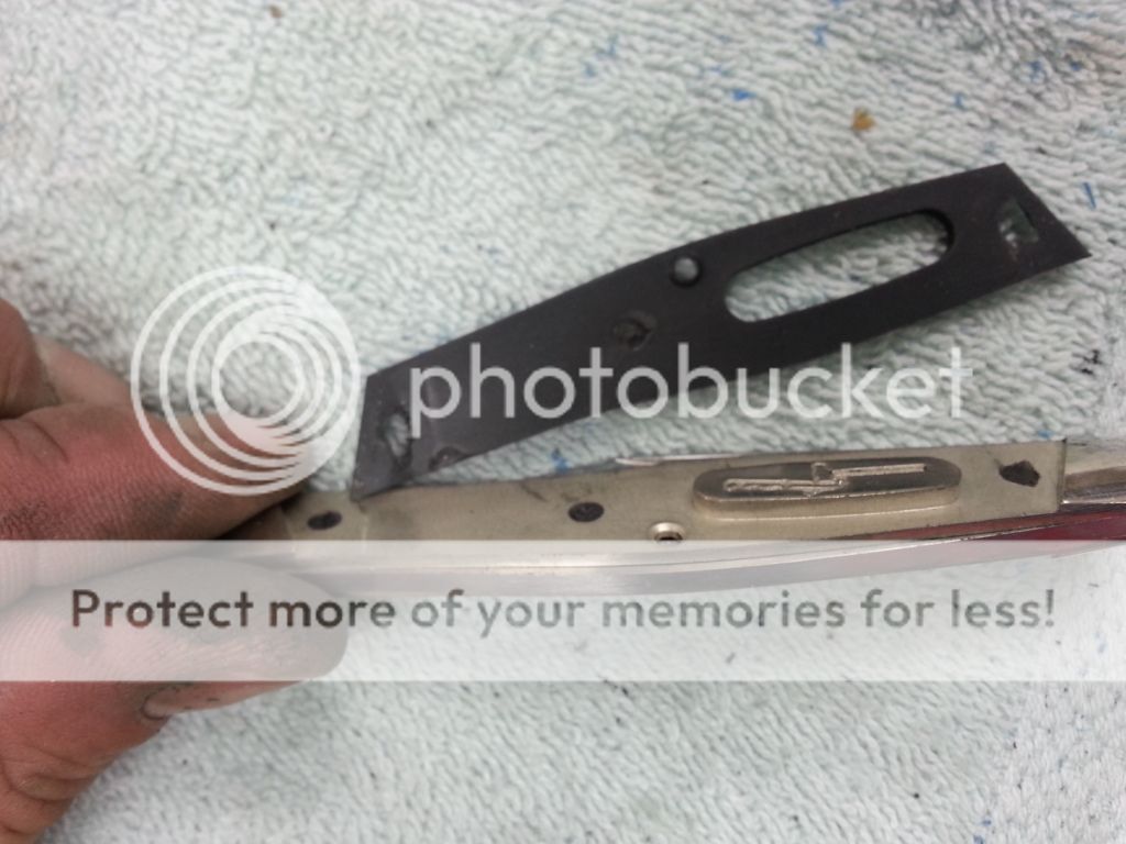

The shield appears to be soldered to the liner, instead of inlayed into the scale which they were previously. I bet this adds a lot to the structural integrity of the knife.
Does anyone know when this started? 300bucks maybe?
Rather than try and remove it and risk damaging the knife, I worked around it. :)
I say it's either soldered or cast into it. See the lack of a seam where it meets the liner? There's no evidence of pins inside the liner.

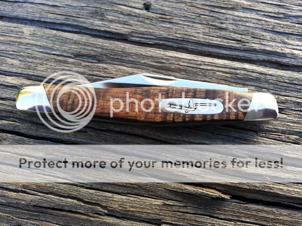

Here it is finished

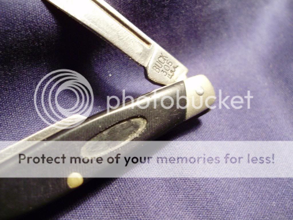

That's pretty cool. I wonder if all the Buck made 300s are like that.
Here's a Camillus made one missing its regular-type shield.
ETA: Beautiful mod on that knife, JAG!

I bet you had to squint to cut around that.

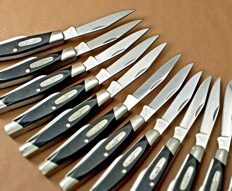

Shields, Round end shields are Buck made, the pillar shield are cast in place as are the bolsters. If you are looking at a photo of front, note the SS spring rivet and the hammer on the shield has a straight shaft and closed end. Earlier shields showed taper shaft and open ended. The one piece liner/shield/bolster was 90 or 91, by memory, but flat ground blades went on to the 1990's ended when the Edge 2000 program design took over. The flat ground blades of the late 80's went to the top of spine of the clip blade, in the late 90's a flat edge spine was made about down to the bottom of the nail nic, then the flat tapered blade went to the cutting edge from there.
If football is dull will look for photo....300
Here are 303s top is 90 on down into 2000 (far right knife). You can see the flat on top of the spine, and you see how a little more polishing was taking place back then. About the middle knife is when the flat blade world started easing out. I believe just about every one of these shields are solids.
THe escutcheon shield is not soldered on or pinned on. It is one piece. I've sanded them off. This was the only way I could remove it. DM
Only black Valox sawcut scales have the solid shield pillar. All Dymondwoods have glued in shield 'plates'. Go to JAGs top and second photo, you can see how the Valox scales are made with plastic rivets that go thru the liner holes and are heat riveted, that is the plastic rivet end is melted and flattened against the inside of the liner to hold it in place. 300
